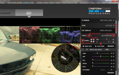

Thank you so much for working with Sony to resolve the Black frame issue. Question: Is there a way in the new Studio Premium to turn on the scopes and histogram that was in FirstLight?

To turn on the scopes waveforms etc. in Studio Premium/Professional is actually far easier than FirstLight.
The top left panel it scrollable and expandable (more goodies can be revealed.)
