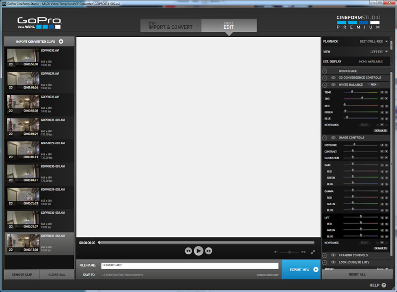

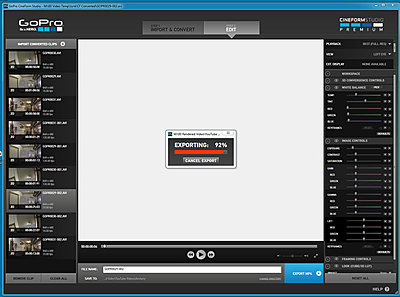

In Cineform Studio Premium:
When I shoot video with my GoPro Hero HD2, import the MP4 file into the software, and convert it to an AVI while changing the frame rate, the preview window in the Edit screen frequently goes totally white after the clip is selected. If the screen is white, then pressing the Play button does nothing. If you scrub forward, then back to the in-point, it'll display the preview properly and pressing the play button works correctly. Sometimes it flashes white during playback, but if you scrub back to where it flashed, it won't do it again!
If I shoot a clip at 120fps on the GoPro, import it into the software, convert it to AVI at 10fps (to show an arrow's flight) and try to export this frame-rate-changed AVI video to MP4, it freezes before completion, usually at 82-93%, and CPU usage drops to zero.
See the attached pictures.

Just an idea, if you are running your clips from RAID, try running them from the C: drive and see if they don't freeze up. This sometimes worked for me on Studio - don't know about Studio Premium.
