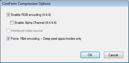

Here is a beta of a patched QuickTime component.
http://software.gopro.com/PC/CFHDCodec.zip
Unzip and copy over the component in C:\Program Files (x86)\QuickTime\QTComponents
Within After Effects use the Trillion+ and at least a 16-bit composite, and the QuickTime codec settings enable "Force 16-bit encoding". This is new. AE broke when we added support for MPEG Streamclip which does support deep pixel. This new 16-bit control always advance apps like AE to co-exist with 8-bit only apps.

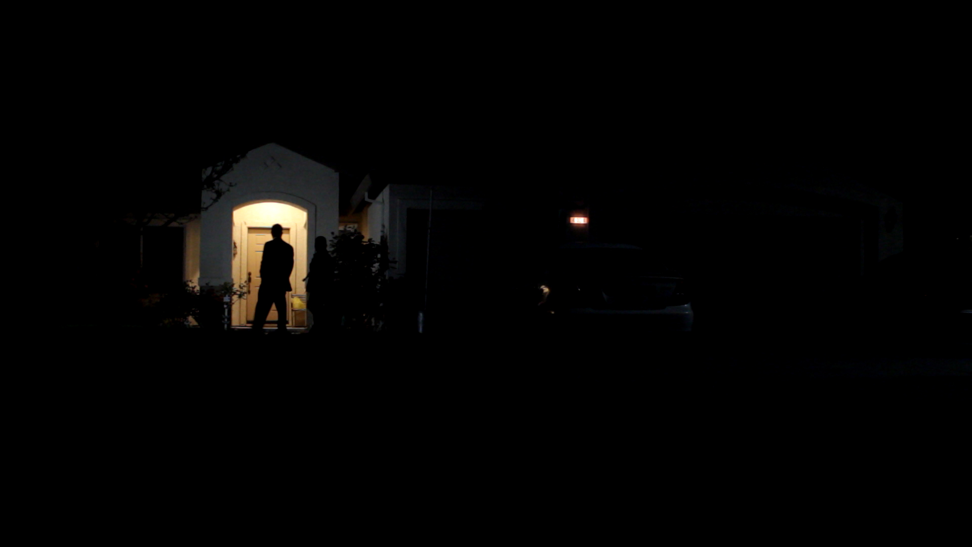

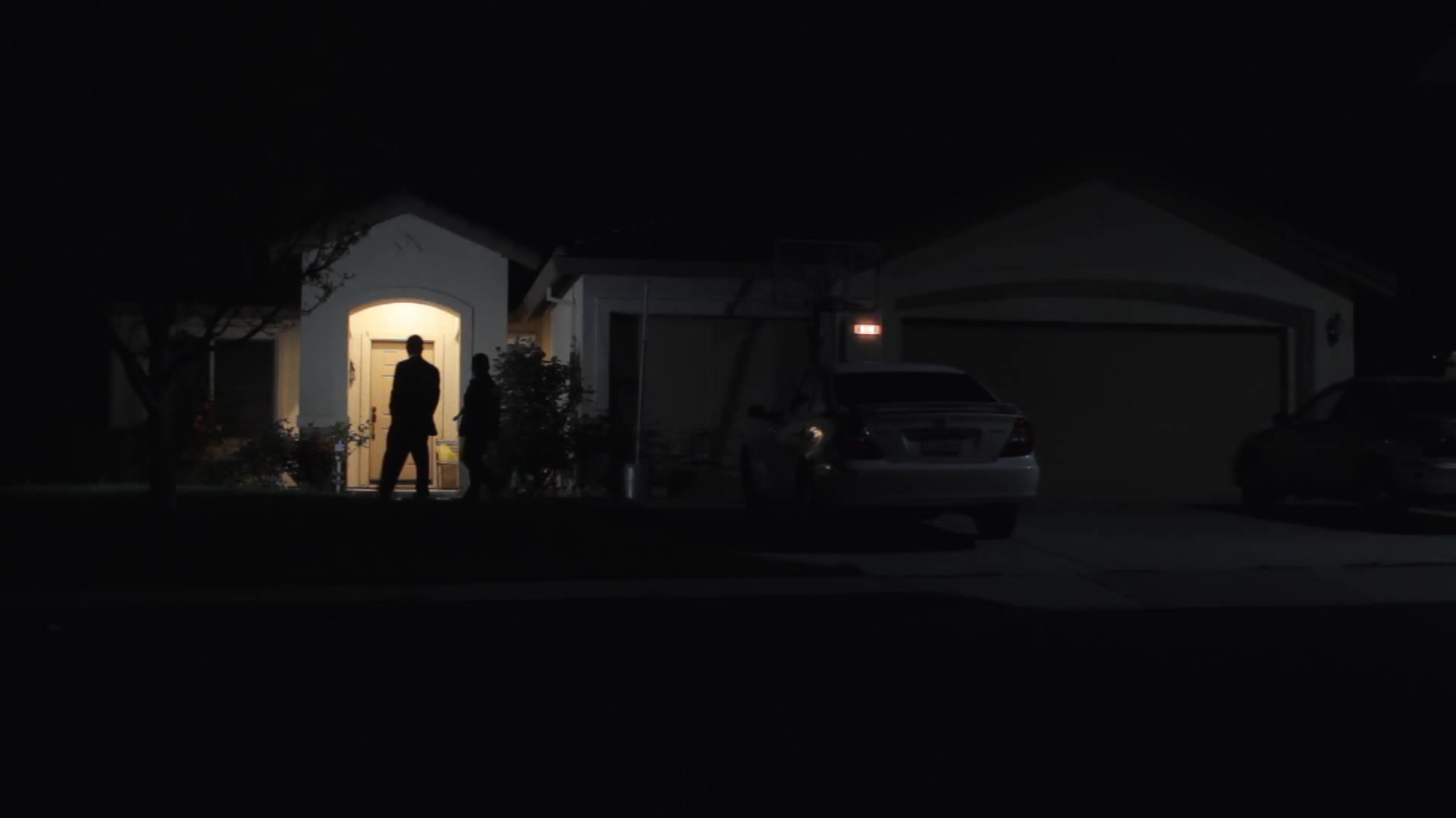

Here are the stills attached.
QT-MOV is the file produced by rendering QT MOV with force 16 bit and Trillions of colors.
Processing space is 32 bit in After Effects. Afterwards the same Gain-gamma -Lift are applied to both. Shadow detailed revealed in the original AVI, but is completely lost in QT mov

Re: Cineform quicktime After Effects Render = tripple image, shifted color channels.
This is normal. Floating point will not protect your supers (white or black extremes) when going to most codecs. A Codec must have ranges between zero (darkest black) and one (brightest white.) The source data was in YUV, which has black at 16 (Y - Luminance) and white at 235, which means can have supers. So to map YUV into RGB, without lossing data you much use studioRGB, something Vegas does by default but few other tools. For cameras that using full range YUV we automatically correct for this (Canon DSLR), but you are likely using something else. If you have supers and want to use them in After Effects, you will need to pre-gain the image in a 32-bit comp, or fix it inside the CineForm metadata (easier.) To convert to studioRGB, set the lift to 0.062 and the gain to 0.86, than way nothing will be lost.
