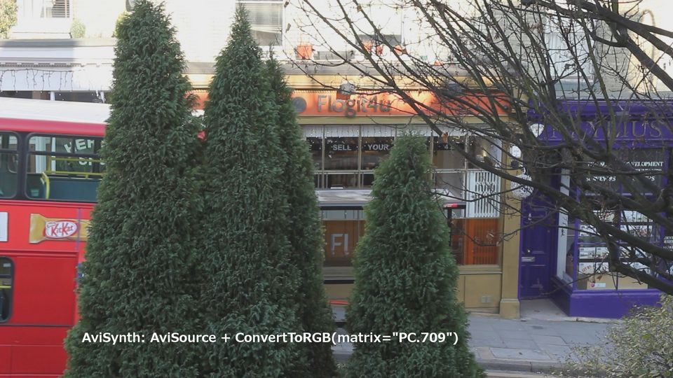

Ok, forget about my Vegas issues and the other thread. Here's a simplified question:
1. Running NeoScene 562 on win7x64. I'm converting Canon 60D mov files to CineForm avi files through HDLink. Do the QuickTime\DirectShow\VfW components installed on my system affect the conversion in any way?
2. Bellow are 2 snapshots of a CineForm avi converted from a Canon 60D mov, processed through AviSynth. Which one of the two accurately represents the correct colors?

Canon 60D and Neoscene-60d_cf_rgb-pc601-_text.jpg   Canon 60D and Neoscene-60d_cf_rgb-pc709-_text.jpg

I believe all Canon DSLRs are full range Rec601 (other than the new Canon 5D MkIII which is full range Rec709.) HDLink and CineForm Studio knows about this Canon oddity and will convert 601 full range into 709 broadcast range -- this brings Canon footage in compliance with all other HD cameras. So your test is not about Canon source, but about the CineForm output, which means the image on the right is correct (unless Canon has changed the 60D to 709 -- I can tell my looking at the MOV header, just need a small file.)

I've attached a small 60D clip, it would be nice if you can confirm that the 60D does indeed use full-range 601.
In any case, I can confirm that a CineForm avi created with HDLink, with a ConvertToRGB(matrix="Rec709") filter in Avisynth matches *exactly* the colors and levels I'm seeing in Canon's ZoomBrowser.
It also matches *exactly* the original 60D mov with a ConvertToRGB(matrix="PC.601") filter in Avisynth.
Does that make sense?
If so I guess I can rely on that being the correct interpretation of the original.

While you effectively confirmed the 601 nature of the source, I also checked your 60D clip, and it is 601.

Unfortunately, this confirms that - at least on my system - Vegas Pro 11 is incorrectly treating the native 60D mov as 709.
If I want to import a 60D mov into Vegas, and then correctly export to CineForm, I have to manually add a 601->709 correction, plus a Computer->Studio RGB correction.
I guess it's time to open a support ticket with Sony.
