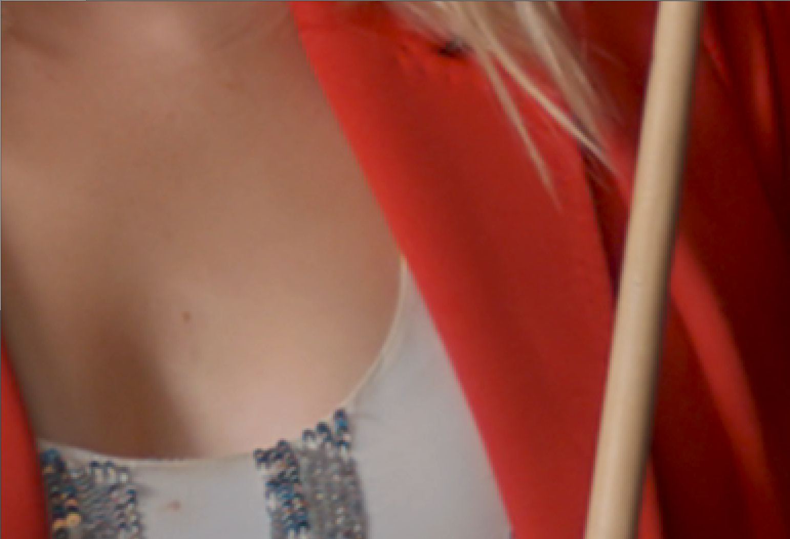

I´m currently setting up my workflow for the Black Magic Camera and Cineform RAW and I´m running into problems when using the cineform codec to render a master file.
Have a look at those pictures
1. That´s RAW. Cineform 4:4:4 looks identical.
http://www.steinhardtverlag.de/Felix/raw.JPG

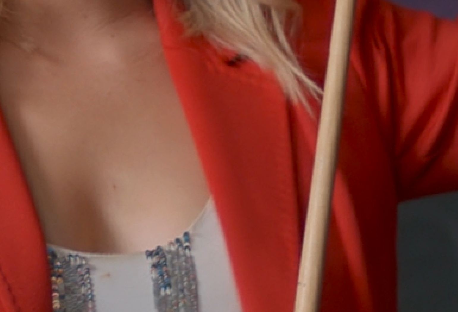

2. 422. There is strange artifacting at color edges. Like saw teeth. I first thougt, this is the downside of 422 compared to 444.
http://www.steinhardtverlag.de/Felix/422.JPG
3. But pic 3 shows an x264 rendering directly from the raw file. x264 is just 4:2:0 and it looks good. Much less atrifacts than 422.
http://www.steinhardtverlag.de/Felix/x264.JPG
I´m using Premiere CS5.5 and the current beta version of cineform studio premium.
What´s going on ?
Best
Felix

That is a display artifact not an encoding one. How are you outputing the JPG frames? You might try setting the "Filter 422 to 444" option within the "C" systray icon under "Decoder Settings"

I output a single frame as tiff and then made the crop in photoshop.
I already see the artifacts in the premiere preview when I reimport the clip.
Filter 422 as 444 didn´t help. Hmmm. I have no idea. The files look the same in Sony Vegas I just found out. No Premiere display problem.
I can of course output 444 but it´s unnecessary since a debayered and scaled picture of the BMC is only 4:2:2.

I will look into why 4:2:2 to 4:4:4 filter is disbled in the 1.3 beta, should be an easy fix. As for 4:2:2 being equivalent because of bayer, that is not completely true, it is somewhere is between 4:2:2 and 4:4:4. Why not post in CineForm RAW?

I just fixed the 4:2:2 to 4:4:4 presentation bug. All 4:2:2 encodings are fine.
