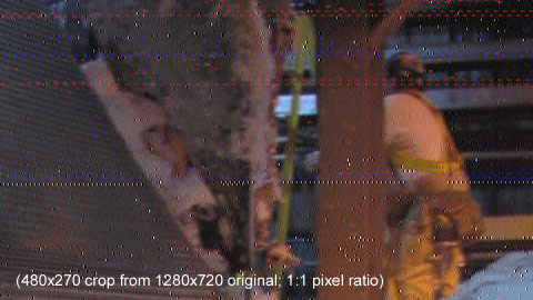

I'm wondering if this is a common problem with an easy solution. About 5% of my captures, and a large percentage of my rendered Cineform AVI files, end up being corrupt with noise similar to the crop shown below.
Not only do they show this distortion, Windows Explorer and Media Player will often crash trying to load them.
In the case of captures, re-capturing the clip often works the second time, but it's a bit of a pain to go back (especially when things get hectic).
Renders, on the other hand (so far just from After Effects), give this result more frequently, and often a second or third attempt doesn't help.
The clips are all originating from the JVC GY-HD100U, HDV-HD24p, and the version of AspectHD I'm currently running is 4.0.2.54. Anyone know how to avoid this? (settings, upgrades, etc.?)

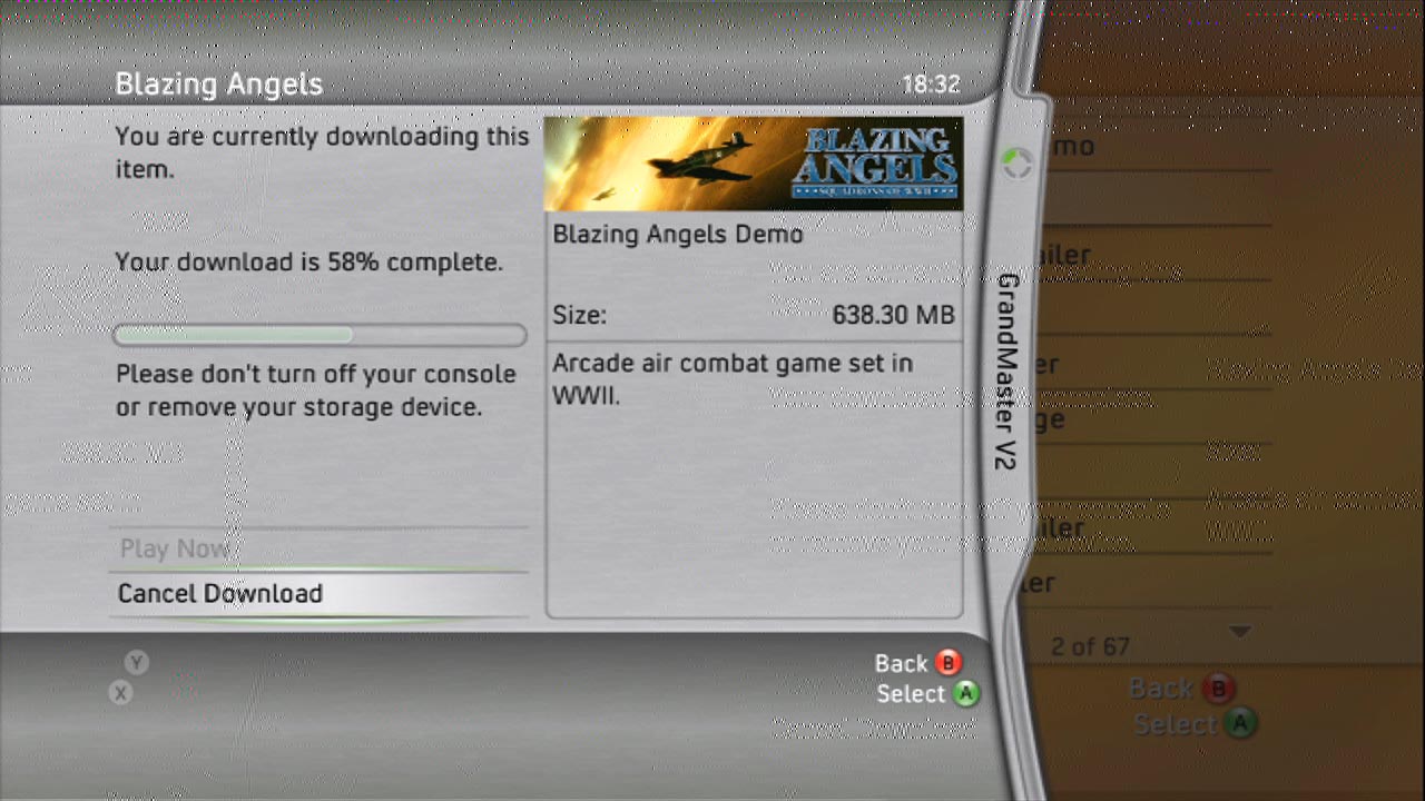

I too have seen this issue on my own captures - the artefacts look very similar and yes, the captures won't play in Media Player. However, it's not a general DirectShow failure as my 'good' clips still work fine.
However, I am using dedicated software that talks directly to the DirectShow components in CineForm software so thought it was more to do with my own workflow rather than any fault in the CineForm products.
I'd say that this happens on 5% of my captures too. I cannot comment on CineForm renders as I prefer to export uncompressed from Premiere Pro 2.0. However, I'm sure the DirectShow encoder handles those duties too.
I am doing a big batch of captures over the next few days for a presentation I am working on, so if the bug manifests itself, I will post a screenshot or two.
EDIT: Just did a quick capture session and managed to get 'lucky' with a clip. Screenshot attached. David, I'm uploading a 12mb RARed CFHD onto our FTP site for you to take a look at - should be there in 30 mins.
A couple of notes on this. Firstly, I never have this problem using the VFW codec. Secondly, my software gives me a preview window of the DirectShow encoder's output and it always looks fine which is a bit of a puzzler.

This was fixed with verssion 4.0.3 (build 55 -- one later then you where using, it was introduced in build 49) and now it is totally gone Aspect HD 4.1.1. Try keeping up guys. ;)
I can be jokely now because that was a painful bug to find (it was related to the new CineForm RAW in PHD -- a little code crept to where it wasn't supposed to be.)
