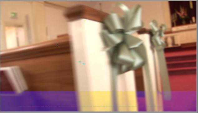

A few weeks ago, I decided to build a dual AMD Opteron system in anticipation for a short film I'm filming right now and intend to edit in HDV. Unfortunately, even after upgrading to this great new machine, one thing after another has prevented me from finding a successful HDV workflow. Not one, not two, but three different HDV solutions have failed me and I am completely unsure as to what to do.
Editing HDV Natively in Premiere Pro 2.0 fails. I can preview the video fine but as soon as I render the preview after adding any effects, small blocks and lines appear in the image. Exporting to any format retains these lines and striations.
AspectHD in Premiere Pro fails. These same blocks and striations, plus odd patterns appear in different frames of the image. This is outside of Premiere as well. Any conversion or playing of the Cineform .avi continues to contain these artifacts. Oddly enough the artifacts are in different parts of the image each time, meaning they obviously aren't part of the file but rather mistakes int he way they are being decoded. I've sent an extensive explanation of the problem to Cineform support but it's obvious they have no clue what's going on.
DVFilm Maker with Raylight fails. Maker refuses to convert any .mpeg files without crashing by the end of it. Converting Cineform avi's is flawless however the artifacts described above remain in the image.
I have no options left for HDV editing and I am at my wit's end. Any last resorts?

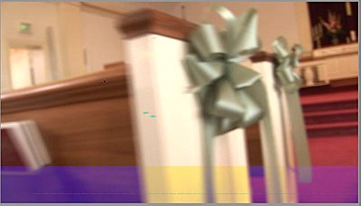

I am using an FX1.
Bob, I have four tapes of wedding footage shot completely without an adapter and these problems happen regardless. Besides, the artifacting is too intense to be compression side effects. Also, I used to have that problem as described in that topic but as supposed I was using ConnectHD (still trying to get a refund for that too).
Trying another HDD sounds like a good idea. Right now it's four SATA 250GB raided together in a RAID 5. Maybe this is a problem?
EDIT: Nope. Tried capturing and playing back from my humble IDE C: drive with the same results.

Ash, it's a small chapel in Ellicott City, Maryland. Curtis, the footage is flawless when viewed in Premiere native .mpeg but the artifacts occur when rendering effects, meaning whatever format (read: codec) Premiere is rendering the previews in is obviously causing the issue. This smells very badly like a codec issue. But I'v reinstalled Windows and gotten the same problem, so it's obviously hardware-related...

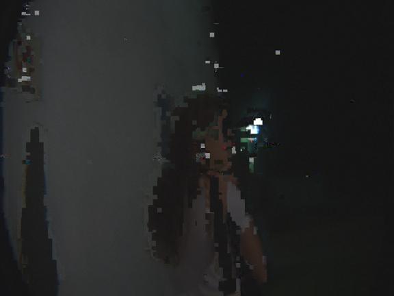

Ok, did some more testing...
Rendering an mpeg with a 180 degree motion effect and a small scale increase reveals no artifacts. However layering this clip with another clip, setting opacity to 50% and adding a fast blur to the bottom layer and rendering gives artifacts.
Exporting this to mpeg as suggested reveals no artifacts...
So maybe I can edit in mpeg native, and just make do with the artifacts when previewing knowing that they won't turn out in the final product? But what's causing it?
Plus I'd really like to get Aspect to work. Not to mention that I need a 24p workflow for my 60i footage, and Raylight is the only way to go right now. But DVFilm Maker crashing is a whole other topic.

1. Are both cores of your system actually being utilized by system ?? (Google AMD Power Monitor and download it.) It will monitor the cores to see if both are operating. Since this is self built, did you use set up disks to be sure proper drivers on board, and dual core operation is active. On my motherboard, I had to update the BIOS to get proper operation.
2. What are you using for a Video Card. I don't know for a fact, but I believe PPro utilizes Video card resources. I assume you have a decent card, but if you have a system that shares video memory, that could be a problem. (Just guessing at this.)

Figured out DVFilm Maker!
It is crashing because it is running up against it's 4GB/18-minute barrier. I am trying to convert files that are 20 minutes long at the least. Converting shorter files ran OK.
To answer your questions:
1. Yes, all four cores seem to be utilized. In fact, reducing Premiere's usage to 1 or 2 cores using Set Affinity seems to reduce the amount of artifacts appearing in the image. Hmm...
2. I am using the Matrox Parhelia APVe as recommended by Cineform.
