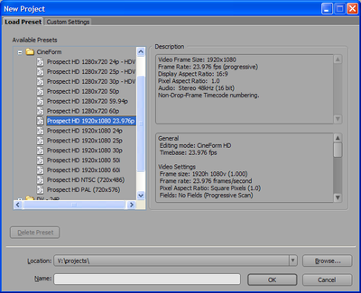

Don't seem like you are using Prospect HD presets. Here is the full list in the image below. Plus you can modify as preset as needed -- like adding a new framerate or pixel aspect ratio.

Definitely using the presets. The only non-HD presets are with a non-changable .9 pixel ratio. It is shown on the screen.
At first I tried the DV NTSC setting. But there didn't appear to be anyway to change from the .9 pixel ratio.

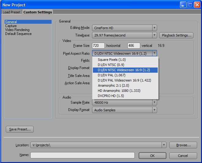

Nothing is "non-changable". Select the NTSC preset, then click on the "custom settings" and select the pixel aspect you want.

David,
Your right...my brain must be mush. It is there in the custom settings and I've got it going now.
