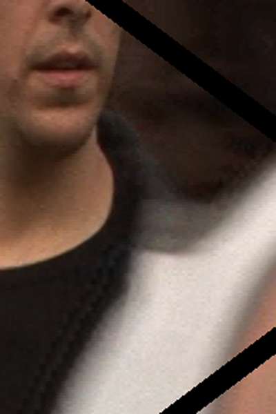

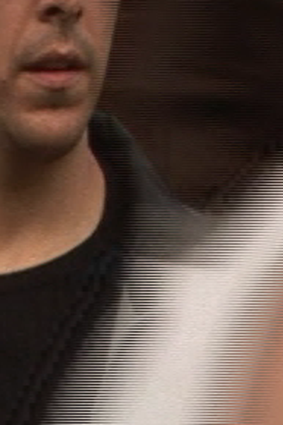

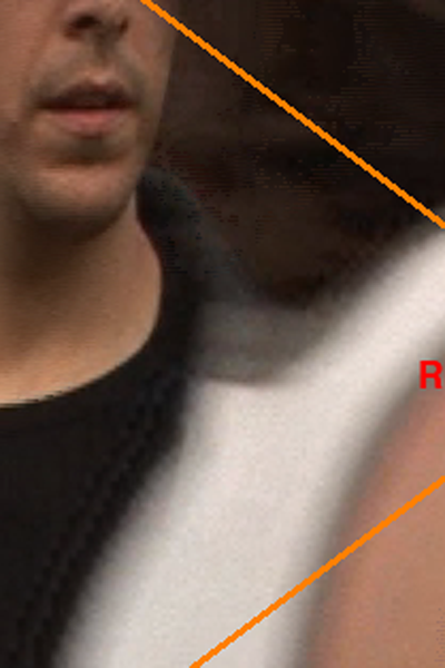

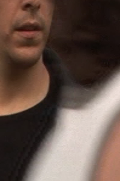

Side-by-side I tested Boris Continuum Complete 4 Deinterlace, RevisionFX Fieldskit (both added as an effect) and TMPGEnc Xpress (imported after having processed) on an identical clip.
My test is a 2 sec clip where some blokes walk across camera with a nice brick wall and angry man in the background.
In motion these all pretty much looked the same. However, viewing a detail of a still lets us see just how well the DI'er coped with it.
Frame 1 is the untouched interlaced original, complete with combing!
Frame 2 is Boris Continuum Complete 4 Deinterlacer.
Frame 3 is RevisionFX Fieldskit 2.
Frame 4 is TMPGEnc Xpress.
Fieldskit has introduced some nasty digital artifacts which Boris hasn't, but I think TMPGEnc Xpress looks slightly nicer of the 3.
I'm using default settings for all the examples, except:
Boris Deinterlacer (setting Upper Field First)
FieldsKit (detect motion, 2 frames, point difference?)
TMPGEnc Xpress (Deinterlace Always - Interpolate - Animation 2)
By the way for rendering the 2 second clip, FieldsKit took 94 seconds, Boris took 55 seconds and TMPGEnc took 9 seconds. Have to stress though that I haven't exhaustively checked the resolution loss if any.
Methinks using an external DI'er is always gonna be quicker than using a Premiere or AE plug-in.
DVFilmMaker is also worth looking at, but the GUI is pants and needs some work - it's not obvious if you're by default adding Red and motion blur to your footage etc...
Artifacts are another discussion altogether, I don't want to hijack this thread - I might post some examples and some testing of the Boris Continuum Complete 4 Denoise plugin, it might save a couple of shots I'm having problems with.

Douglas... great job with the stills.
I see what you're saying about the processing of individual clips... that's how I should have described my thinking as well.... smart DI wouldn't work very well globally.
I didn't even realize that the TMPEGenc had a smart de-interlacer function... very good news, and time to give it a whirl. At least for that expense you would get two very important functions.
