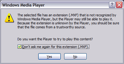

Yes you should be able to play an MXF in MediaPlayer, although MediaPlayer complain. Select an the MXF and selecte "Open Width...", then Select Window Media Player from the list. Then say Yes to try playing it -- it will play fine but without audio.

David, Does the fact that Media Player plays the entire video
mean there's still hope for salvaging my clip?
I did what you suggested, and the clip plays in its' entirety using Media Player, but without the audio. (Thanks for that tip).
