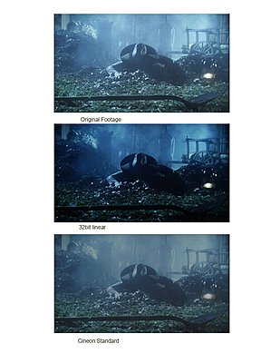

I`ve made some quick test and that is what i`ve got.
I guess that the post guys (and me) didnt export correctly the LOG files.
Thank you for uncovering the misteries of the cineform exports in AE.

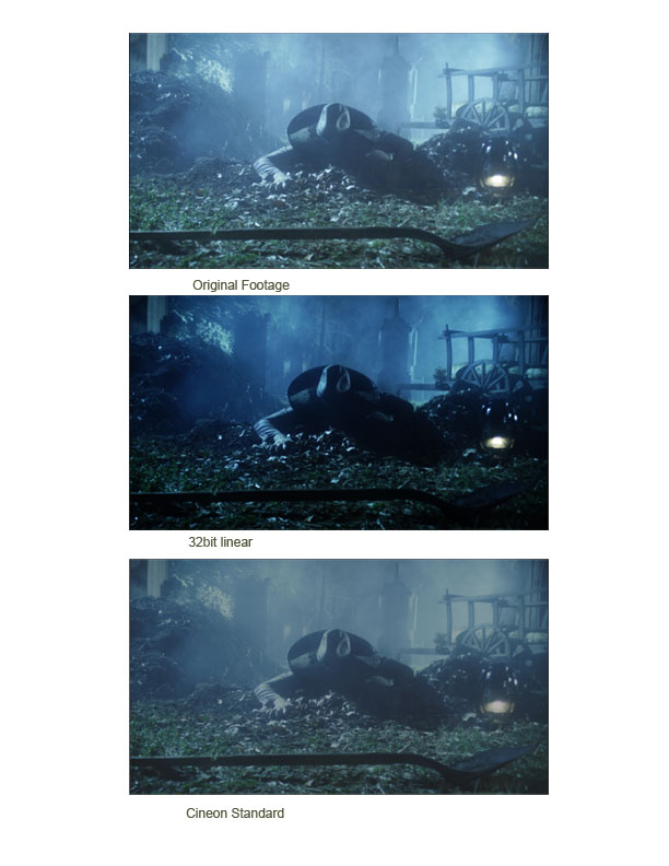

Here`s another one, this one was shot with the latest GigeAPP and later Cineform RAW, i believe is a more accurate example.
I made a fast color correction example of the exported Cineform in Fusion.
Today im having a film out preview, i think this will be very handy.
Thank you both.

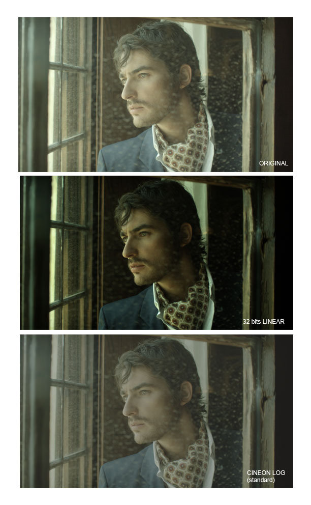

Hello Jason, David and Sergio,
I've take the .jpgs you showed above and tried David's steps in AE.
I found that all of them were done using the AE cineon converter's default setting of gamma 1.7.
But according to AE's documentation to convert from logarithmic to linear the gamma should be set to 1.0
Or was I always wrong about it? I guess I've never fully understand the cineon gamma setting.
Where does that 1.7 come from anyway? If it's for normal viewing then shouldn't it be 2.2?
And setting it to 2.2 the result is not even equivalent to applying a "level" effect with gamma 2.2!
I'm so confused. Please help me figure it out!
Eric Wu
Eric Wu is offline   Reply With Quote
Old June 26th, 2007, 07:34 AM   #24
Join Date: Mar 2003
Location: Virginia Beach, VA
Posts: 1,095
Eric, you are right, the gamma should be set at 1.0, not the 1.7 that After Effects sets the gamma to. This is because in the 32-bit float mode, we're actually now a photometrically linear file.
The confusion of course comes in the math that Kodak uses for their Cineon equation. The gamma correction for a linear source should be 1.0, but in their equation, they have a Display Gamma input that gets divided by a constant of 1.7:
Display Gamma / 1.7 = Final Gamma
After Effects' implementation creates confusion because those familiar with the Cineon equation think that the "gamma" that AE is giving them access to is the Display Gamma setting from the Kodak Cineon equation, where-as it's actually the Final Gamma, which is already divided by 1.7 (or something close to that). So for instance, if you thought you were adjusting the Display Gamma input (which you're not), you would set the Adobe gamma setting to 1.7 . . . but in actuality you're adjusting the Final Gamma, which would make setting 1.7 incorrect, you want a Final Gamma of 1.0.
So in essence, Sergio's files are too dark to be Cineon-compliant.
Jason Rodriguez is offline   Reply With Quote

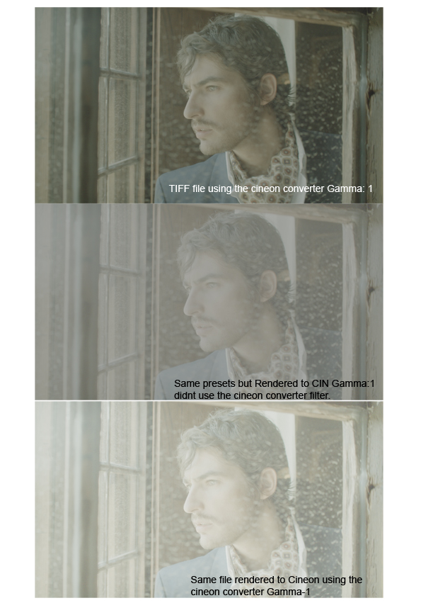

I`ve been doing some cineon exports. I`ve used only the render to cineon options. But i`ve noticed that the final renders looks very different when rendering to cineon than when applying the cineon converter filter.
My question is how can i render to dpx or cin when using the cineon converter filter?.
Because i`ve noticed that if you use the cineon converter and render to cineon/dpx AE combine both and image doesnt work.
I had to render to tif (or any image extension) but not to .cin/.dpx.
Sergio Sanchez is offline   Reply With Quote
Old July 6th, 2007, 10:53 AM   #27
Location: Taiwan
Posts: 32
Hello Sergio,
If you already use the cineon converter effect on the footage(s), then when you render to cineon sequence you should choose the "Full Range" preset in the format options. If you use the "Standard" preset then it will do the linear to log conversion again and the result will be incorrect. I think that may be what went wrong with your result.
