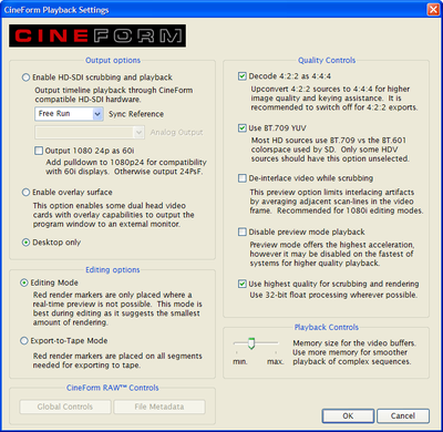

Okay, I uninstalled the Xena drivers, re-installed from the AJAIO directory, and still see nothing through the monitor. I went into playback settings and see no reference to Xena, just the normal settings as outlined in the Prospect HD manual on page 35-36. The manual implies these are the settings for the Xena cards. Should there be a preset just for Xena LH monitoring?
BTW, I've captured HDV footage, upped the rez to 1920 x 1080i, and have the project set as a Cineform Prospect HD 1080i project.
Stuart

The setup you want is "Enable HD-SDI scrubbing and playback" as pictured here.
