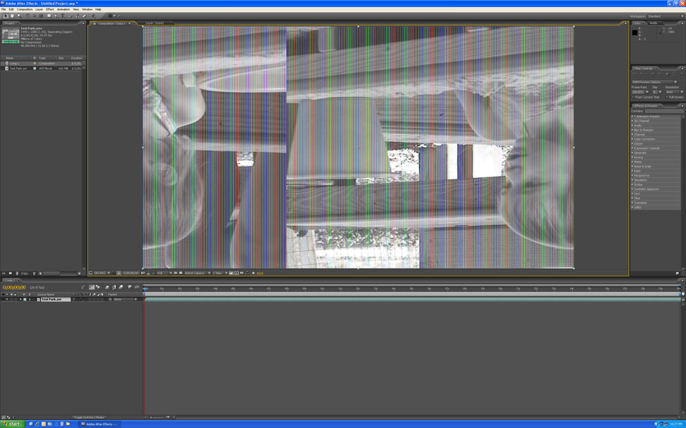

Sorry for the laundry list of problems but:
I took a clip just captured with PPro and CF5 Build 85 and if you look at the clip directly in After Effects CS3, it will play but if you try to put it to a timeline you get a screwed up picture that is kind of upside down and has vertical stripes all through it.
I attached a screen grab to this message.
This does NOT happen on AE 7.0 with Cineform, just AE CS3
Stacy

Yes you need to remove to new components that don't work (yet) with CineForm -- They are ImporterDirectShow.prm, and ImporterAVI.prm from the Mediacore directory (sorry I don't have the exact location.) You will not loose any functionality for CineForm media, and you can restore these for non-CineForm project (if you need.)

Perhaps I'm missing something - I've just tried what you've said and now AE CS3 just says it can't import any avi files, including Cineform ones.
Is there somewhere that describes getting this to work?

Okay, having dug in further it seems I need CFHDIO.aex which I don't have - I'm running ConnectHD because I don't use Premier is it possible to get it to work? I don't mind an upgrade to NEO if I need to.
David,
Only problem is that I commonly use both Cineform and non-cineform material in the same project in AE.
Any idea when this will be fixed?
stacy

NEO does add the CFHDIO.aex module. However, just like Aspect HD I'm not sure it is active my default. Here is the registry tools to turn it on or off.
http://www.dvinfo.net/conf/showpost....4&postcount=12

Originally Posted by Stacy Rothwell View Post
David,
stacy
Most uncompressed AVI materials and some compressed AVIs will work with the CineForm Importer, the main one that doesn't is DV.
When we will fix this? It was impossible to fix under AE 7.0, and we complained to Adobe on many occasions. There is a workaround, load AE and turn off the CineForm importer via the control panel, import all our non-CineForm media, save, and close AE. Reopen AE, and turn the CineForm importer back on, all your media will not work.
The problem with AE CS3 they didn't tell us on their intended fix until couple of months ago, by then it was too late to correctly "fix" their new methods -- CineForm is the only that needs to use it. We find the old API more feature rich. We will likely support the new API (which is based on Premiere's), but I worry is will not be as good as using the CFHDIO module until CS4.

For Aspect HD uses, try removing only the ImporterDirectShow.prm comment, that might restore the behavor to AE 7.0. The many reason for CFHDIO.aex module was to add 10-bit support to AVIs in AE -- i.e a Prospect HD feature.

It works!
Okay - so I installed NEO Player for now and it all works. (With removing the files and altering the registry).
What's also interesting is that I can import standard DV footage no problem too!?

That is a cool finding, maybe CS3 fixed the DV issue with custom AVI I/O modules.
David, I did this but now it will not import ANY AVI files. If I try to just select one of the Cineform AVIs I get an error of AE saying it doesn't know what to do with it.
Stacy

As Simon discovered, you have to set the registry to use the CineForm import module. Look at post #6 of this thread, I think that is the issue. Sorry to have you jump through the hoops, we will be making this easy on CS3 / Aspect HD users shortly.

OK, I finally got my official copy of Production Premioum, got Aspect HD upgraded to v5.0.2 (Build 85) and when I opened AE CS3 I had the same problem.
I tried to hide the ImporterDirectShow.prm and ImporterAVI.prm files below where they were but they seemed to be found. So I moved them to a completely separate area.
Then I ran the AspectHD_AEImporterOn.reg file and when I started AE CS3 I was able to import CFHD files that I had converted with HDLink previously.
It took a while to figure out, but now that all the info is in one place it will be easy to help people do the same thing.
