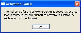

I have been having this issue for a while now. It seems that I can't render in After effects a quicktime file using the cineform codec. I have aspect HD v5 and latest update (85 or 86).
I get the attached error every time I press render!
Is anyone having a similar issue in After Effects? It used to work :(

I have confirmed this is occuring in the last Aspect HD build, but not in any of the Prospect builds, time to see why.
