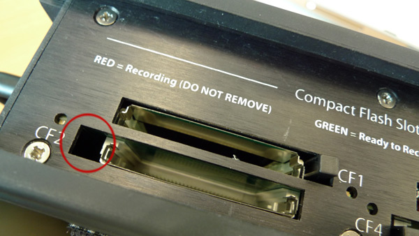

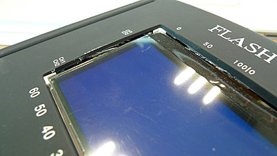

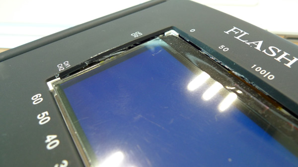

My company got perhaps the 1st Flash XDR in Singapore and we got it to work with our Polecam HD (and occasionally our XDCAM-F355s). I was way excited when it came but the truth set in when I opened up the box. The LCD display was not sealed in any way and the electronics were exposed. My gaffer's first impression was this whole thing will go up in smoke if any rain got in. Of course we were not going to get this in the weather on purpose but to have a LCD display that looked like it had been ripped apart is a tad appalling. As we were going to use it on a shoot the next day, we glued a piece of lcd protector to the unit but that came off...
We still used it however and on our 3rd shoot, the CF card eject button for Slot 2 was used and somehow it managed to loosen and got lost within the innards of the unit...and very normal force was used.
The rest of the unit is well padded but these 2 issues were totally unexpected and being supposedly a new unit, I had expected a better-made product.

we will be glad to repair your unit, please contact us off-list at support@convergent-design.com and we will make arrangements.
Our apologies that you are having trouble. All electronics manufacturers occasionally
face manufacturing defects on particular units, particularly when launching a new product.
We are working hard to prevent and eliminate any such problems.
We are designing a cover for the lcd screen to make the screen more visually appealing, as others have commented on its unfinished appearance.
The Flash XDR has never been promoted as water-proof. Most cameras, for that matter, are not water-proof either. You are correct in assuming that getting the unit wet will potentially damage it.
