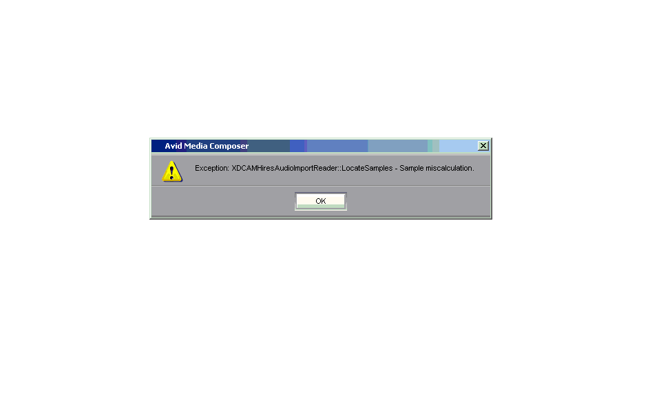

Import Test into Avid Media Composer 3.0.0
I tried importing both 1080i 59.94 MXF files, Avid MC refused to import either file with the same error. Please see the attached error print screen of the malfunction.

Old January 22nd, 2009, 04:37 AM   #7
Join Date: Dec 2002
Location: Augusta Georgia
Posts: 5,421
Dear Mark,
Good Morning!
Thanks for testing.
Dan Keaton

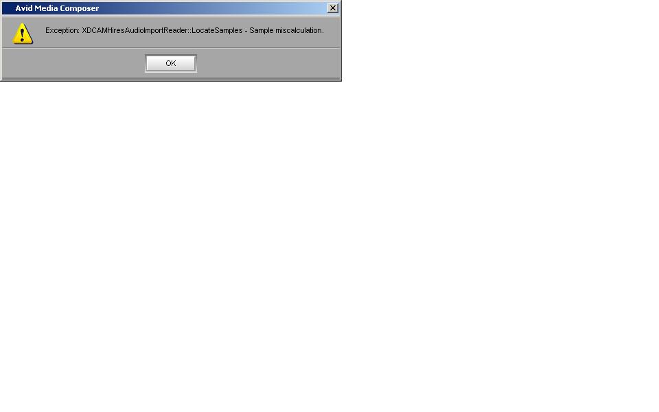

.....Nope. The 160 MB long file also won't import into Avid Media Composer Version 3.0.0. Please see the application's generated error dialogue below......
Mark Job is offline   Reply With Quote

Dear Mark,
Thank you.
I have relayed the error message to our engineers. This is a good clue.
Dan Keaton
