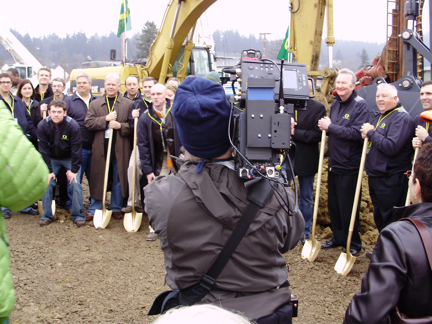

I've been using the IDX NP-L7S Lithium Ion battery mounted on my camera with NP to 4 pin cable to power the XDR and another one to run the camera. I've been thinking of switching to a single larger battery to run both the camera and the XDR so I can see a battery low voltage warning. Something you might consider since the XDR does not have a low voltage warning system and the battery might not be easily accessible to view the meter.
Cheers,
Scott
