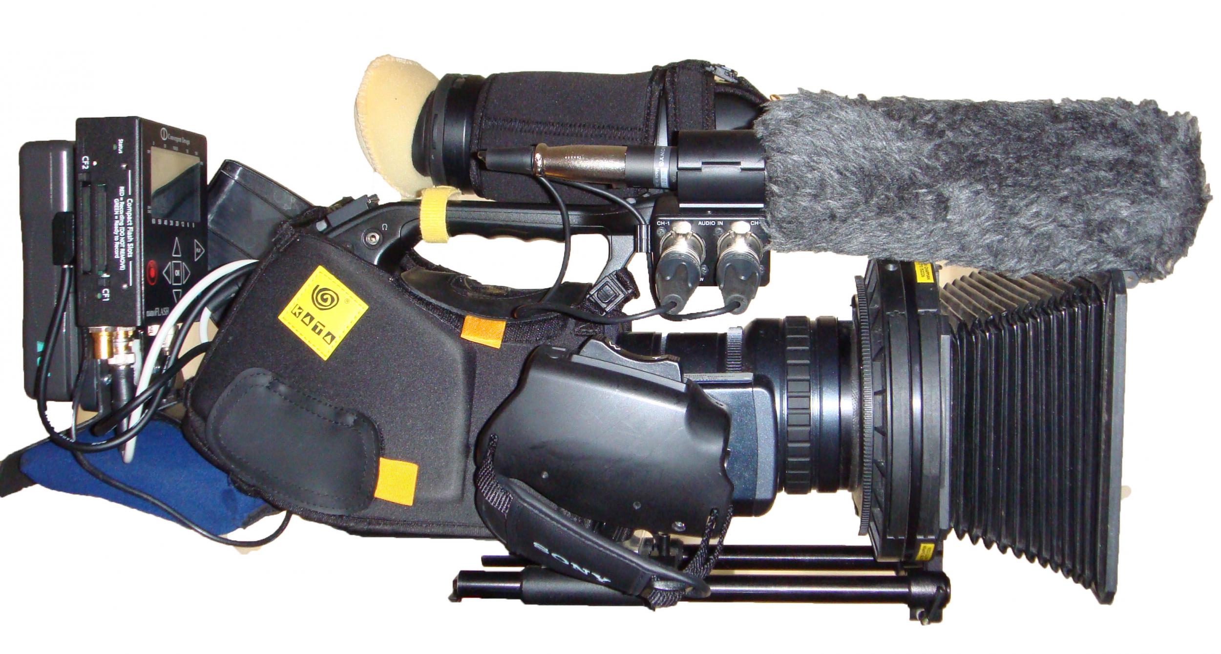

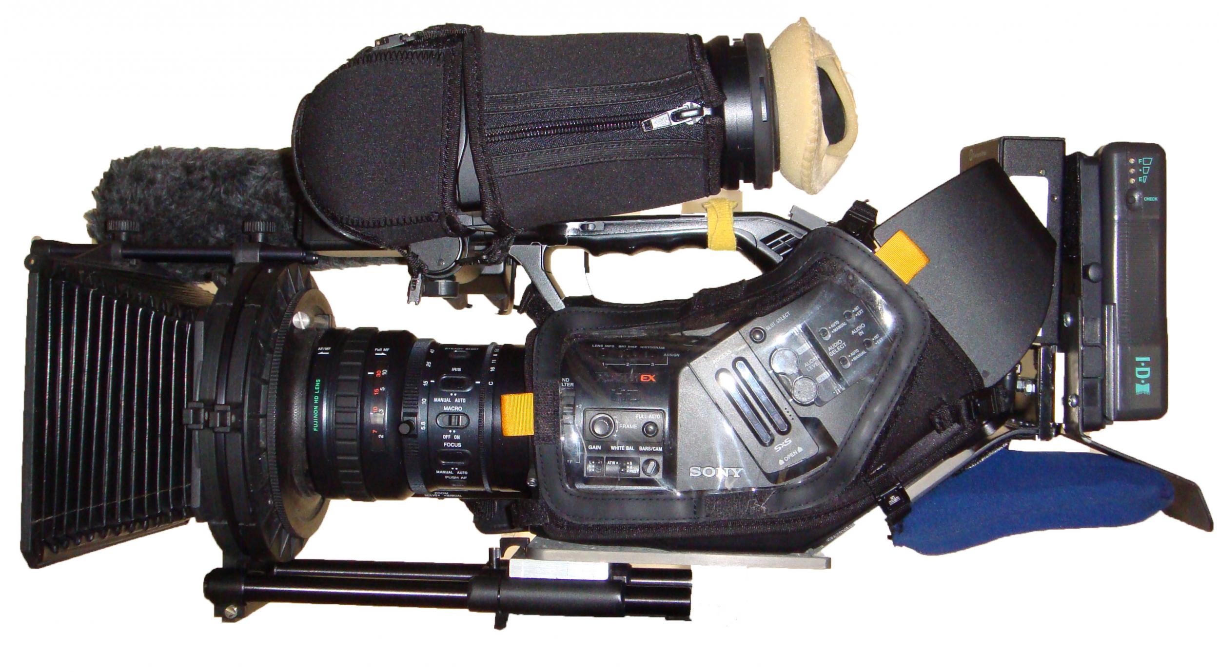

My EX3 - NanoFlash Rig
Thought some of you might like to see my EX3 and NanoFlash rig. I've attached a couple of picture below. You can find out more here XDCAM-USER.com EX3 With NanoFlash Camera rig.

Pardon the possibly dumb question, but how do you integrate starting and stopping the Nano into the system? Obviously you are not reaching behind your head everytime you want to roll. I read about a sensor that attached to the tally light on the camera - is that the answer?
I do like the "belt and suspenders" option of recording SxS and Nano at the same time if that is the case.

You can set the Nano to trigger recording with that setup by:
1. Starting-stopping recording via the camera's button
2. When embedded timecode starts and stops running
3. Remote control cable trigger
You are not limited to controlling recording via only the Nano's faceplate controls

How is the balance? Looks a little front heavy for a long shoot.
