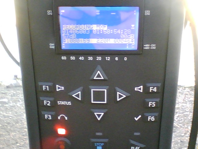

I Shot my first test with the XDR Yesterday Afternoon of a typical Sunset at the beach. I will upload the video with a link here as soon as I can get the upload to my server to work. The quality of the 220 I frame video is spectacular ! However, I have experienced two problems.
1. I get small file chunks only three seconds in length.
2. On one record session, I actually had the XDR go into full motion video capture for about one second, then go back to I frame timelapse all in one movie file. What the ?????
I put the little movies all together on one timeline and was once again faced with editing problems in Avid Media Composer. (Very Sad) I couldn't get MC to output the files to any format other than HDV (Including QT and QT Ref) !! What the ??? I understood I had set my video files to 100 % size on the XD card. (??) Did I miss a setting in TL mode ?

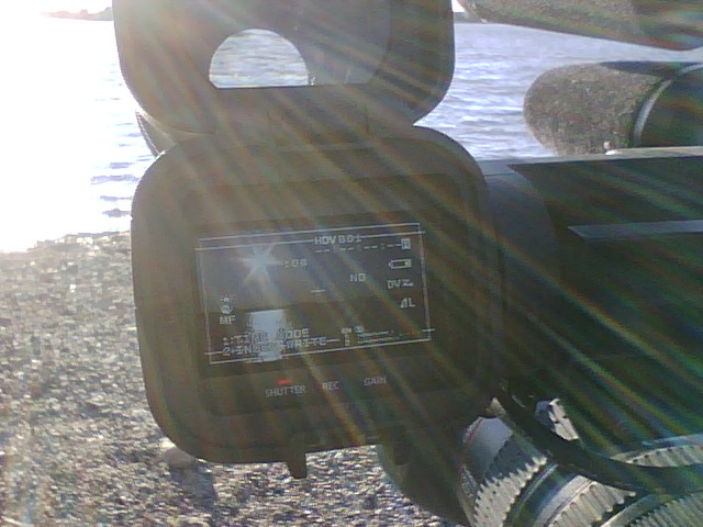

XDR Screen is almost impossible to read in Sunlight (See Picture)
Results of my first XDR Timelapse-1010091711.jpg   Results of my first XDR Timelapse-1010091814.jpg
