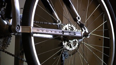

Dear Friends,
If one needs to record both SD and HD at the same time, it currently takes two nanoFlashes, and a good downconverter to convert the HD-SDI output to SD-SDI for the second nanoFlash.
This may make sense for some applications, but for general use I would not recommend it.
Downconverters have to be very sophisticated to be really good. Our experience has shown that some are just not up to the task.
In other areas:
I doubt that we could record a still image and record HD-Video at the same time.
When one records at any of our high bit-rates, say 100 Mbps or higher Long-GOP, and records progressive images, the individual frame captures can look very good.
One interesting side note:
For most recorders, when it says 100 Mbps, you may get 100 Mbps for one format/frame rate, but get a far lower bit-rate for other conditions.
With our recorders, you get 100 Mbps, if you are doing 1080i60 or 1080p24. Thus, if you are using 1080p24 (23.976), you actually get more bits per frame.
So, as Mike said, if you record progressive and use our 160 Mbps Long-GOP, you may find the images to be very good.
NanoFlash features wish list-bike-viper-422.tiff
