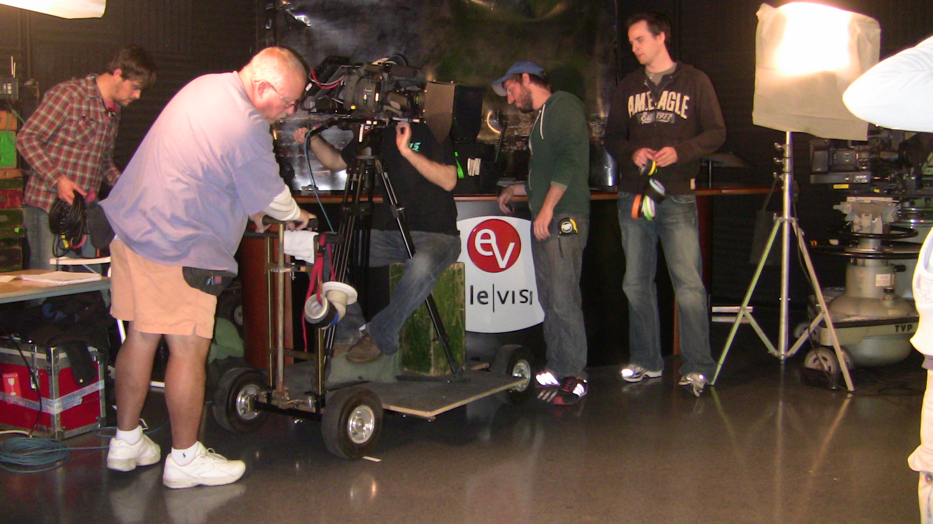

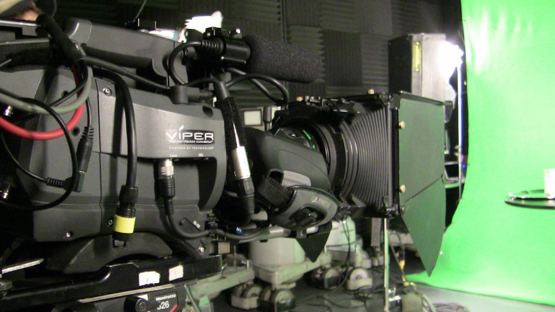

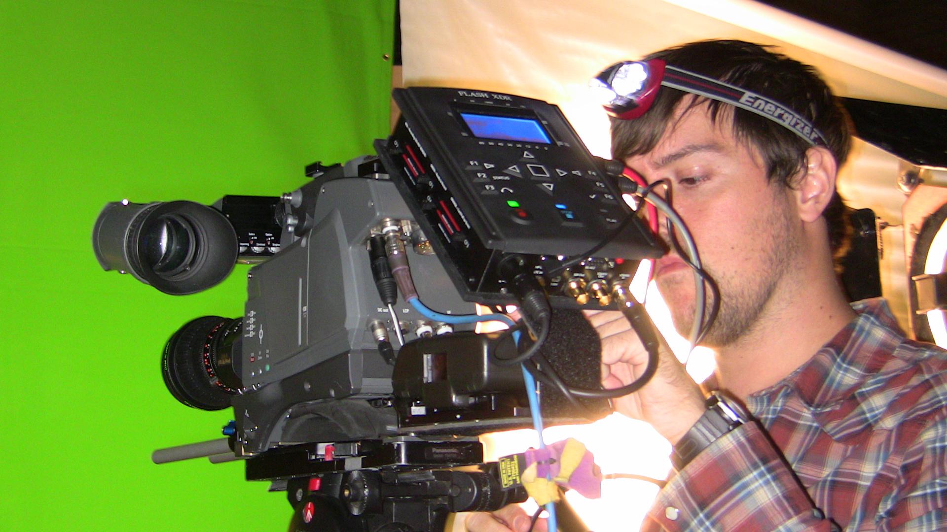

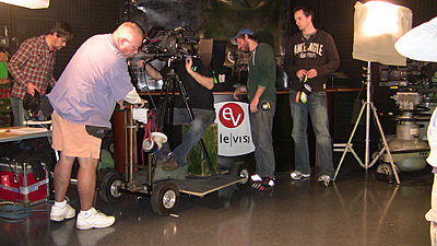

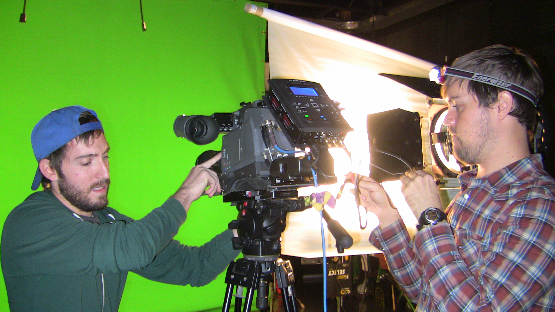

Anyway, here's a few stills from today. Sorry I couldn't get better shots with my blurrycam but I was trying to stay out of the way mostly.
A Few Notes And Stills From The Shoot Today-img_0152.jpg   A Few Notes And Stills From The Shoot Today-img_0146.jpg
