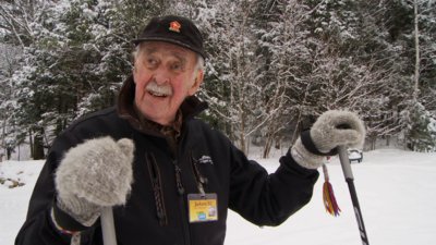

I will be posting a number of comparison shots of Nano and SxS from the new EX1R.
This first one is of my father 81 still skiing XC.
The shot was 1080p 30.
SxS 35mb/s
Nano 100mb/s QT long-gop.
These are uncompressed tiff exports, no manipulation at all.
Can you tell the difference?
I think both are very good.
SxS vs NanoFlash stills-81nano.tif   SxS vs NanoFlash stills-81sxs.tif
Old January 2nd, 2010, 11:57 AM   #2
Posts: 4,957
There is more detail in his mustache and the texture of his fleece jacket is better represented in the NanoFlash still. With so much of the image background being soft due to the DoF this is not a tough test for the EX codec.
Lots of falling snow against a dark background would be a tougher test. In all my NanoFlash footage the difference between it and the native EX or XDCAM HD422 material is hard to spot in all but the most challenging scenes. It's in post production where the difference becomes much more apparent with the 100Mb/s (my chosen bit rate) NanoFlash footage holding up much better during grading etc. I'm really excited about pairing up the nano with my PMW-350 when it arrives. Super clean camera with super clean recordings should allow me to really push things in post if I want.

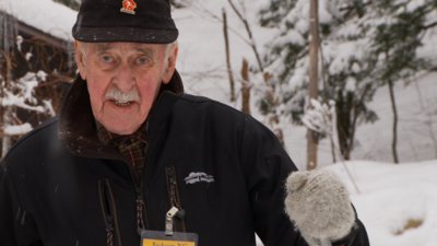

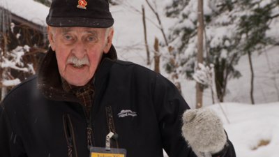

Here are 2 more with much sharper BG.
The shot was 1080p 30. 180º shutter.
SxS 35mb/s
I see very supple differences in the colors. The Nano is more "real", look in the greens in the BG.
I plan on posting a number of different types of shots, that are typical of what I shoot.
I think this will interest people reading this forum.
I am personally really sold on the NanoFlash.
SxS vs NanoFlash stills-nano2.tif   SxS vs NanoFlash stills-sxs2.tif

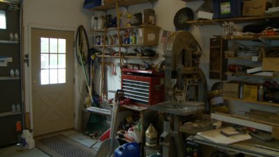

OK here is a third example. Very difficult lighting daylight from the door and fluorescent interior ceiling lights. Walking with cam on shoulder. A little shaky.
SxS 35mb/s
On this one I did levels adjustment equal on both to lighten the shot a little.
Any comments?
SxS vs NanoFlash stills-nano3.tif   SxS vs NanoFlash stills-sxs3.tif
Old January 2nd, 2010, 07:43 PM   #6
Location: San Jose, CA
Posts: 2,222
Regarding your first set, I'm surprised to see that much of a difference on the black jacket zippers as well as the bill of the cap. Nanoflash wins.
I don't see as much of a difference in the second set other than more purple noise in the trees. The Nanoflash images look ever so slightly worse in this regard. Chroma noise? I'd expect that to be better in 4:2:2 . I hate to say it: Nanoflash loses. Any chance you swapped the images?
I see differences in the third set: less noise in the shadows and slightly better detail on the container labels and American flag. The green rake looks sharper in the Nanoflash. Nanoflash wins.

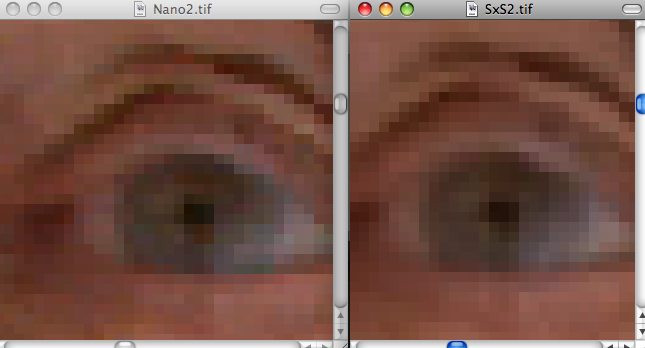

They are really close. I had to zoom in quite a bit to see the Nano deliver more color gradients. see pic. I agree with Rafael. An I frame side by side should be a truer comparison. And diagonal motion subjects would be a true test of the higher bit rate. We have already seen this with the grinding wheel stills that CD has posted.

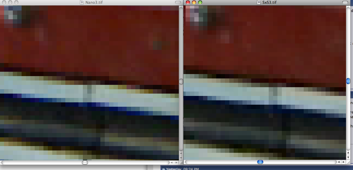

If the blue pixels on the tool box coming from the lower edges of the draws, which have a diagonal aspect are from CA, than the Nano seems to increase the CA . If this is not CA, than the Nano reproduced the blue as it is. I welcome smarter people to contribute.
Dennis Dillon is offline   Reply With Quote
Old January 3rd, 2010, 06:37 PM   #11
Join Date: Dec 2002
Location: Augusta Georgia
Posts: 5,421
Dear Friends,
Personally, I find it hard to make meaningful comparisions.
We know that the nanoFlash is 4:2:2, so that should help make the nanoFlash images better, provided the footage was shot at 50 Mbps or higher.
I wonder if the blue on the bottom edges of the toolbox's drawers are a reflection of the blue plastic gas can. This gas can seems to have light from the windows shining on it.
