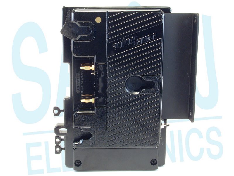

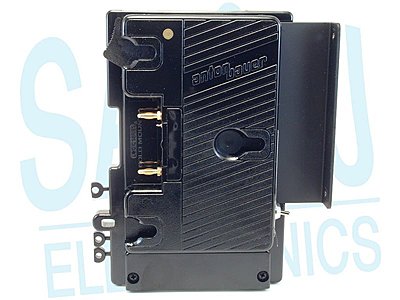

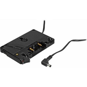

Here's what the Anton Bauer plate looks like. You can see the two mounting holes at the right of the frame.

Hi Jeff,
I am sure I can make what you would like, probably mostly of parts I have already made.
I use the AB gold mount myself on a few plates.
I could not make your link work.
The photo below is of the plate I believe you are talking about.
Give me a call: 603-383-9283 and we can discuss this project.

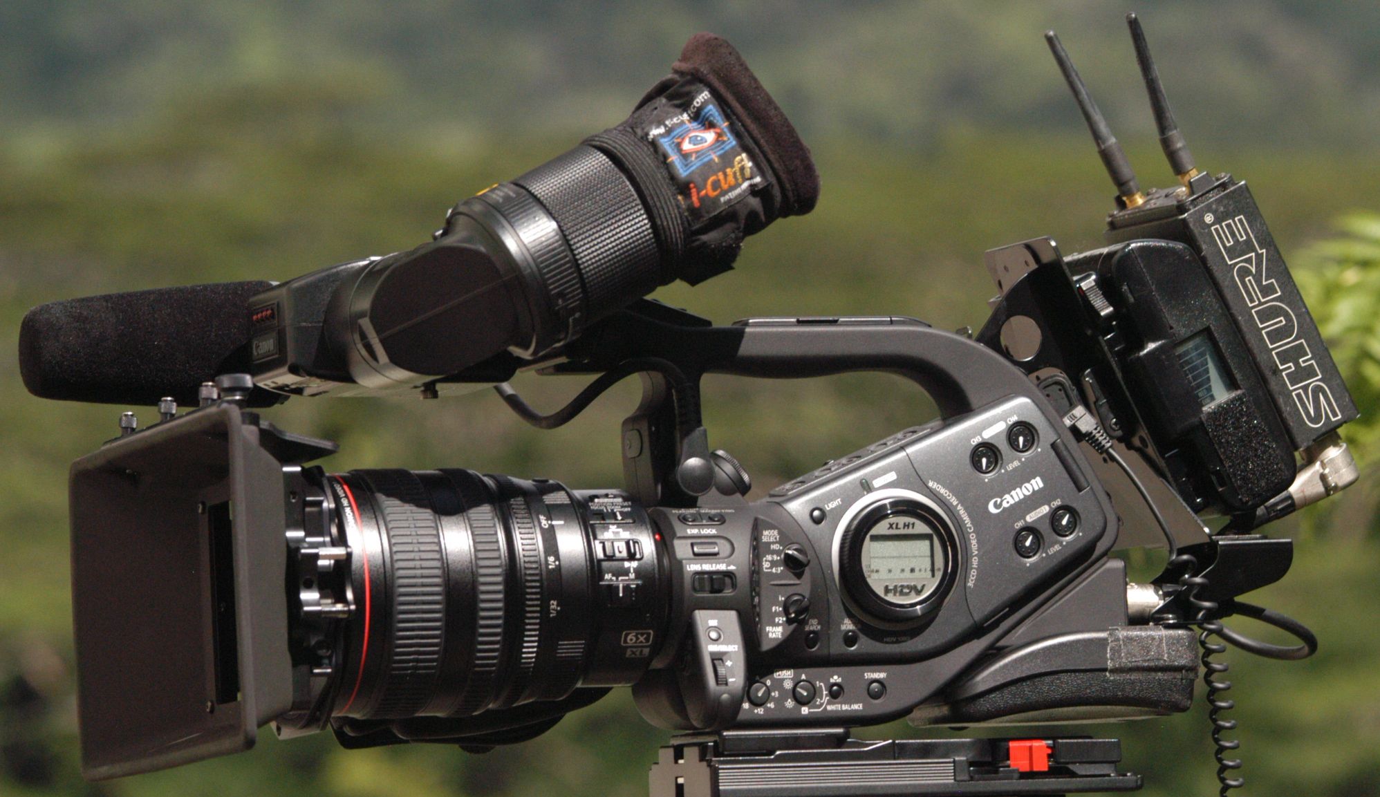

Images of Anton Bauer Wireles Holder
Pardon my ignorance in not getting the images right in my first post on this subject. Here are shots of my XLH1 with a Shure wireless receiver in position where I would like to mount my Nano, and also a shot of the Anton Bauer QDSR, a Gold Mount with wireless plate attached.

It should be very easy to make an aluminum plate that "wraps" around the right side of the
battery. And a set of mounting holes for the NanoFlash on the back.
I have several of the AB plates and a couple AB batts as well. All I need is the exact location of the holes in the plate for the wireless. I think I know what they are, I have an older AB for Betacam plate just like the one in the photo. I just want to make sure.

Hi Jeff,
Just missed your phone call.
I have that exact plate on a Betacam.
The holes are exactly 3 1/8" apart and they are threaded for #6 machine screws.
I can easily make you an aluminum bracket that fits these holes.
Email or call again.

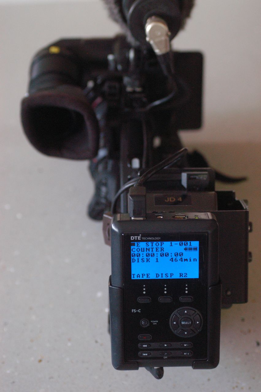

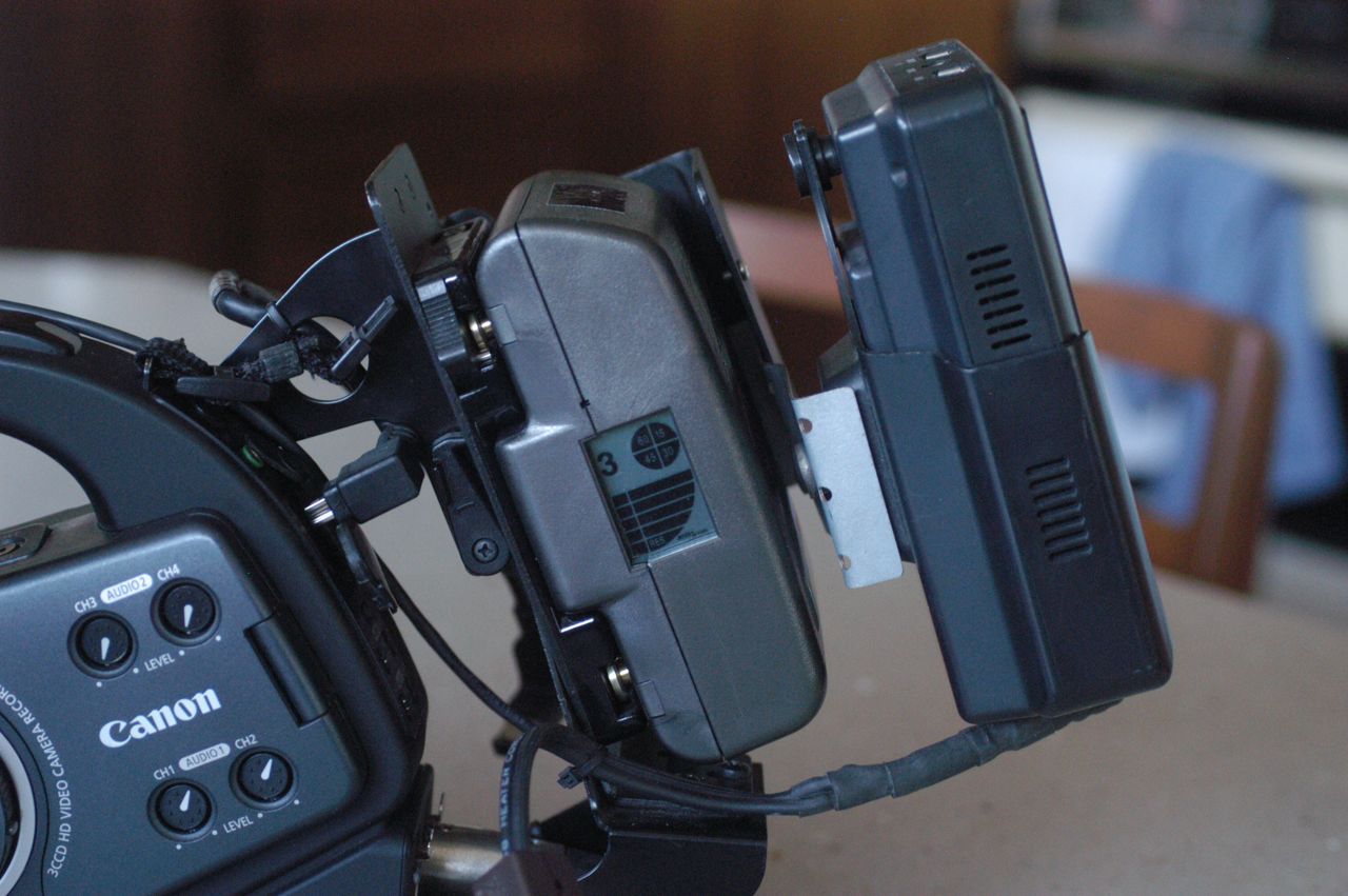

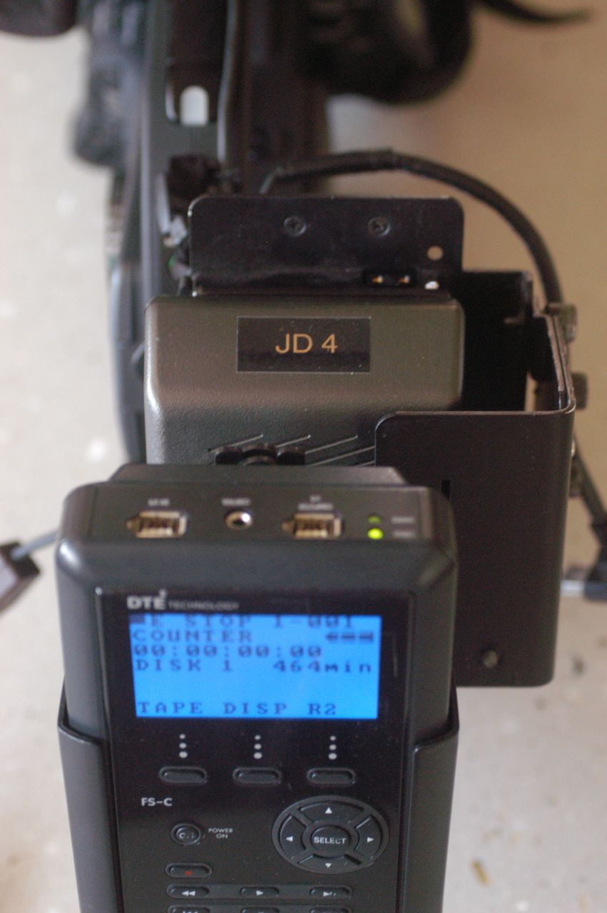

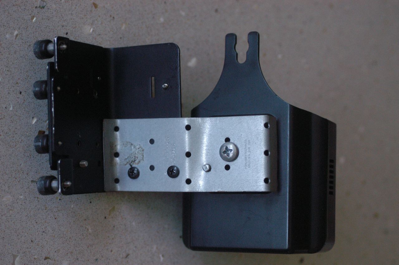

Pics of my FS-C / Anton Bauer Mount
Olof,

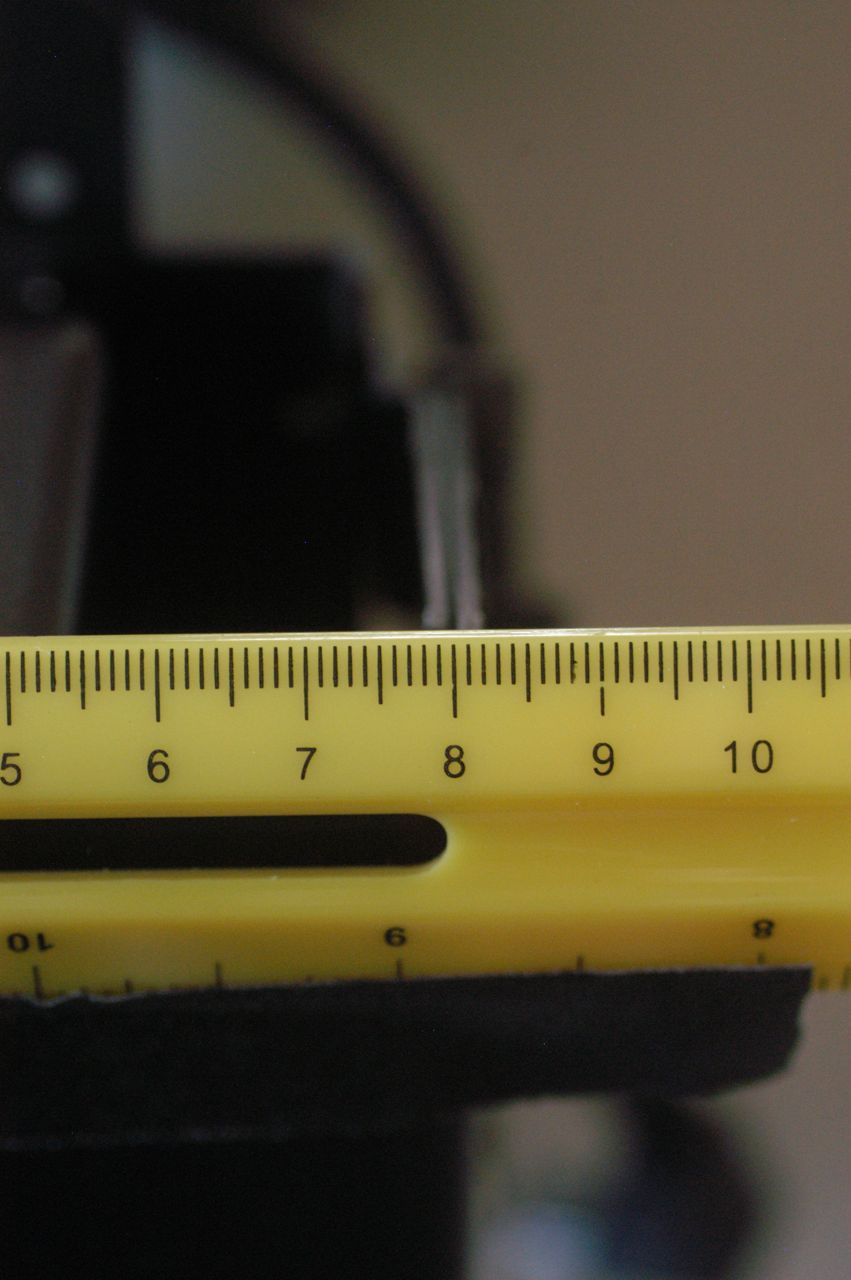

Here are pics of my current setup with my FS-C. I now realized that I would like to have the nanoFlash mount in the same position. (And you'll realize why I want a PROFESSIONALLY made bracket!!!) It's almost exactly the same width as the FS-C, and, as you see from my pics, my mount keeps a nice, straight line from the left side of the camera body through to the edge of the FS-C/Nano. Great for handholding, as nothing sticks out into your head.

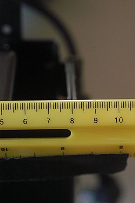

I've included a CU that shows the metric distance from the centerline of the Nano to the bracket. Hope it helps.
Also, assuming that there will be some kind of knurled mounting screw for the Nano, be sure to leave clearance between it and the AB battery. I' asssuming you have a Hytron 50 or Dionic 90 to test clearance???
I need one ASAP. I have a shoot on the 27th, and I want to roll in with your cool bracket.
Mahalo!
Jeff
