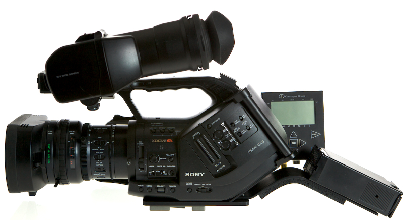

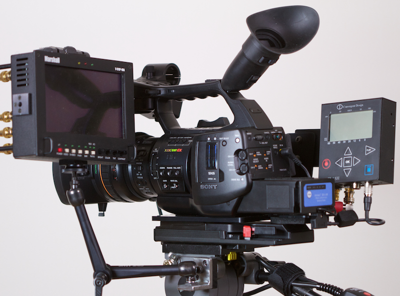

Luben and Lance, my system of wing with NanoFlash arms is a sturdy system for mounting the NanoFlash, and it puts it in a very protected spot.
You can see the system on my WEBsite:
Stronger Tripod Plates . NanoFlash Brackets . Sliders by Westside A V
Or you can contact me for more information or for ordering.
olof@westsideav.com
603.383.9283
EX3 and the rear mounted Nanoflash Issue-safenano1.jpg   EX3 and the rear mounted Nanoflash Issue-safenano2.jpg
