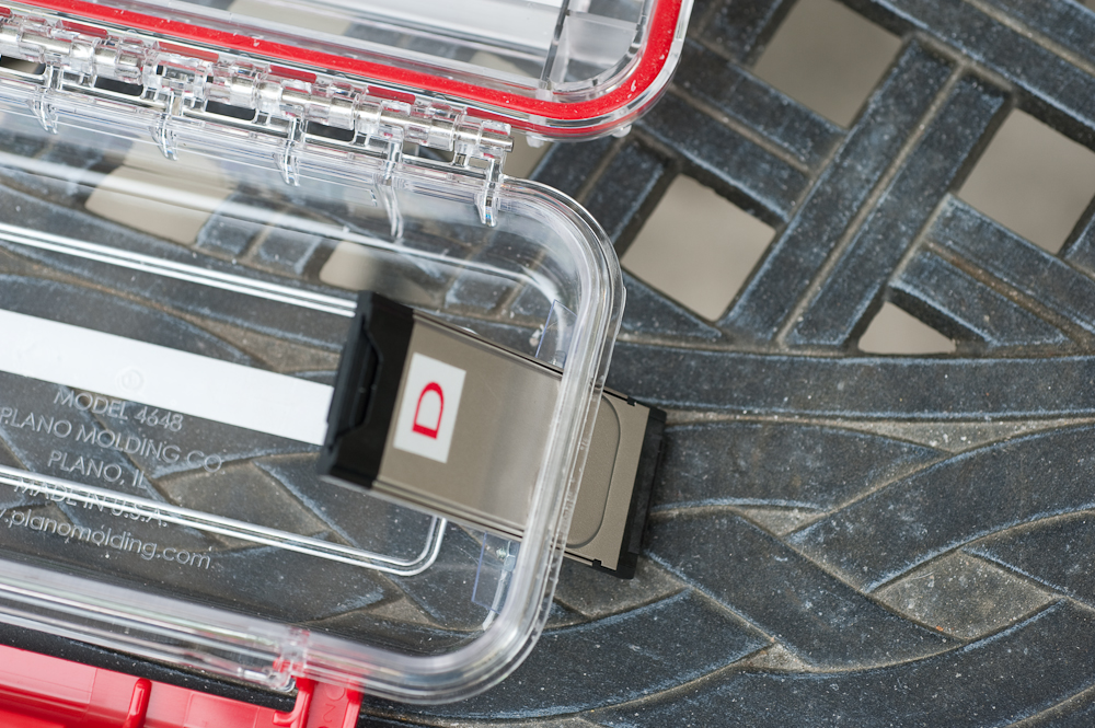

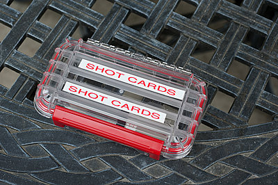

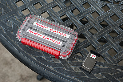

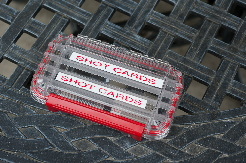

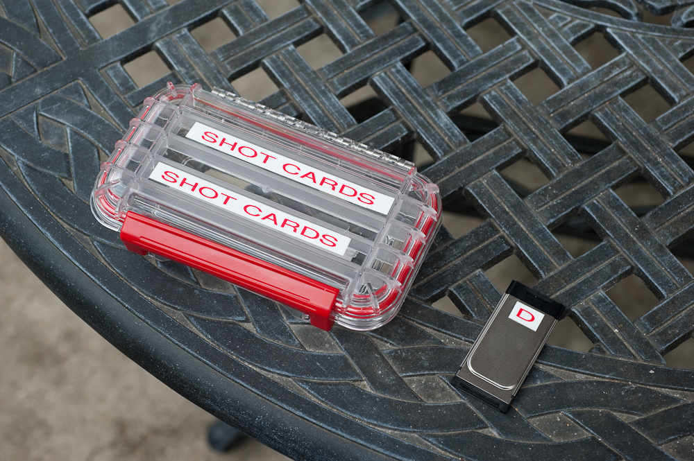

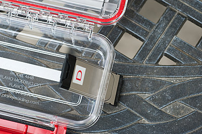

I went in for a doctor's visit last week and looked at the one way function on the "sharps" box on the wall and it occurred to me that concept would be a great way to safely store used cards on a shoot. Also last week I was AC on a shoot with my EX-3, Letus and nanoFlash and at one point felt that dreaded card panic. I managed to keep it all straight, but not worth the risk.

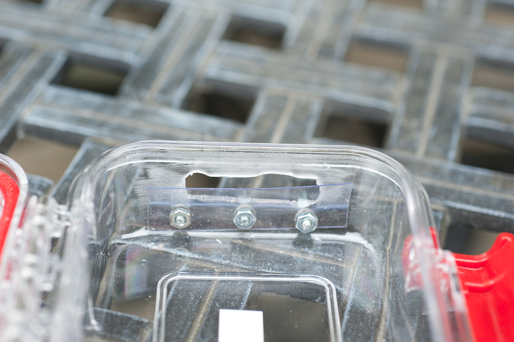

Get a small Pelican or Plano box... say 4" X 7" and 2 "deep. Make a rectangular opening in one end. Take a square of plastic from a blister pack (batteries, consumer electronics stuff)... it is just heavy enough to make a flexible trap door. Drill three holes below the opening and attach the plastic inside the box. Now you can push shot cards into the box and they won't come out. Conspicuously label the box if you like. If you are really paranoid you could put a band of camera tape around the box until you are ready to remove the cards and transfer to your media drive.
The box shown cost $8.00....I will clean up the opening next.

The shoot that I was working on was rolling almost all the time so we were rotating cards...something I vowed never to do, but client asked for higher bit rate and rolled ALOT. Just seemed better to have a safe haven for shot cards. I have used left/right pockets.... shirt pocket/ pants pockets method but in the heat of card swapping anything can happen. I have also labeled ech card A B C D which certainly helps, but is not fool proof and what I was after here is totally fool proof.
