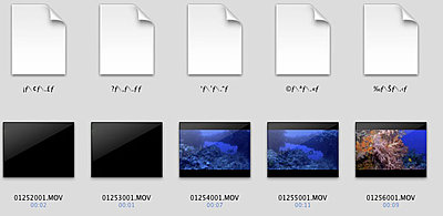

I've got a serious problem with Nano. Once I finished recording few clips I've noticed that some are missing. Nano stopped recording them to CF card and left strange files on the card. Please see attached screen shot. All clips were recorded on SxS card without any problems.

I haven't seen those, but I did experience something odd recently with my nano. I was using the previous firmware version (1.1.154). All clips and sub-clips were fine except for the very last one. The shoot was long format... over an hour of continuous recording at 100 mbps Long GOP. That last sub-clip is labeled as an .mov file, but FCP says it is an unrecognized file type and will not import. Interestingly, it plays from the nano OK.
I don't know if this could be related... just thought I'd add my $.02.

I've had the colour of gray from the NF and the only thing that "helps" you experiencing that is the connection cable to the NF (either HDMI or SDI). Please check your cables or replace them to be sure and try again. I had it with HDMI connection. Hope this helps.

If it helps I have recently seen a similar thing on further investigation it was found that the problem was caused by an intermittent connection caused by a cheap right angle BNC connector on the SDI input of the Nanoflash. (Not supplied by CD)
Since I have discarded the connector I have not had any further problems.
