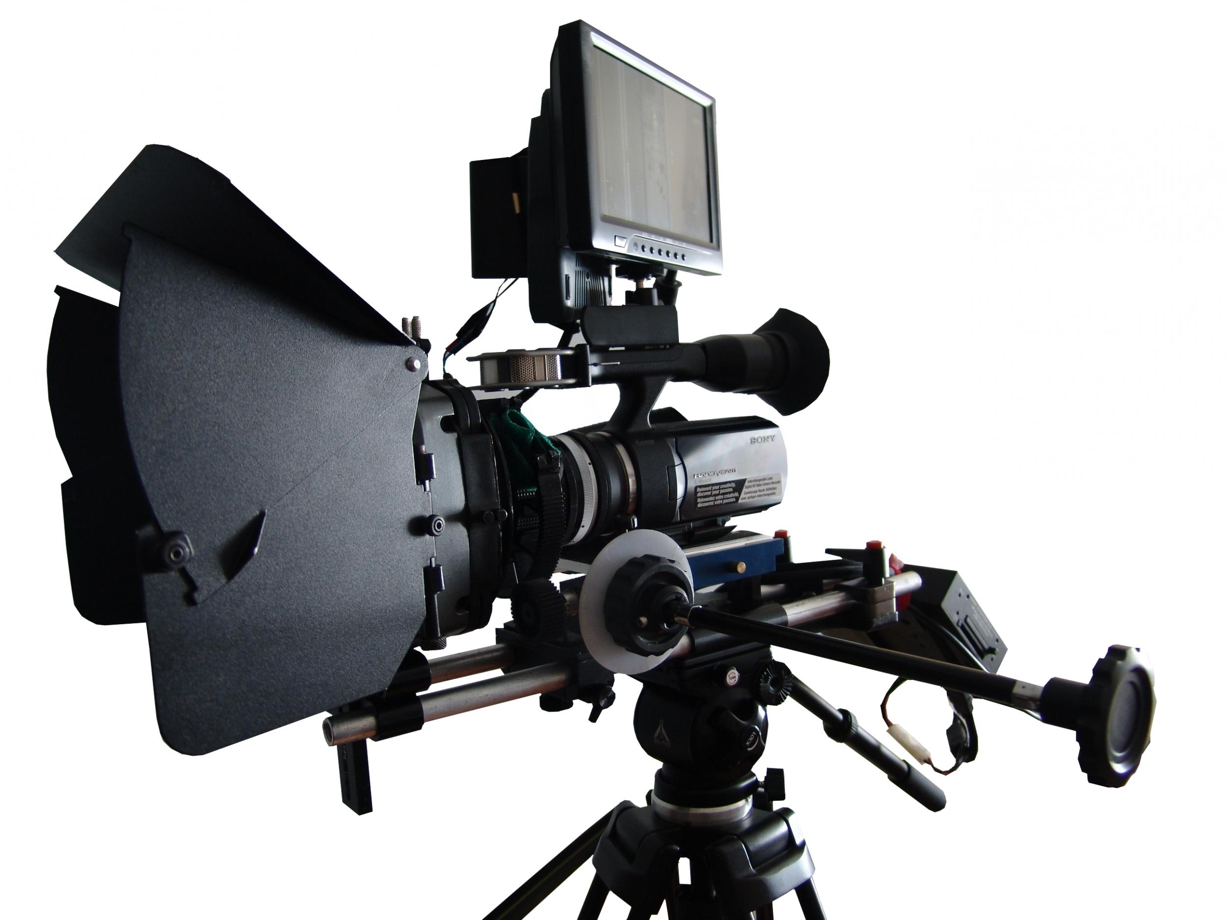

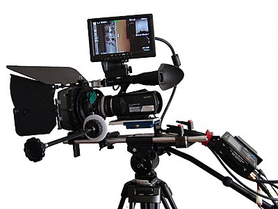

hi, here is my rig for the nanoflash + nex-vg10, is working as a shoulder system too
