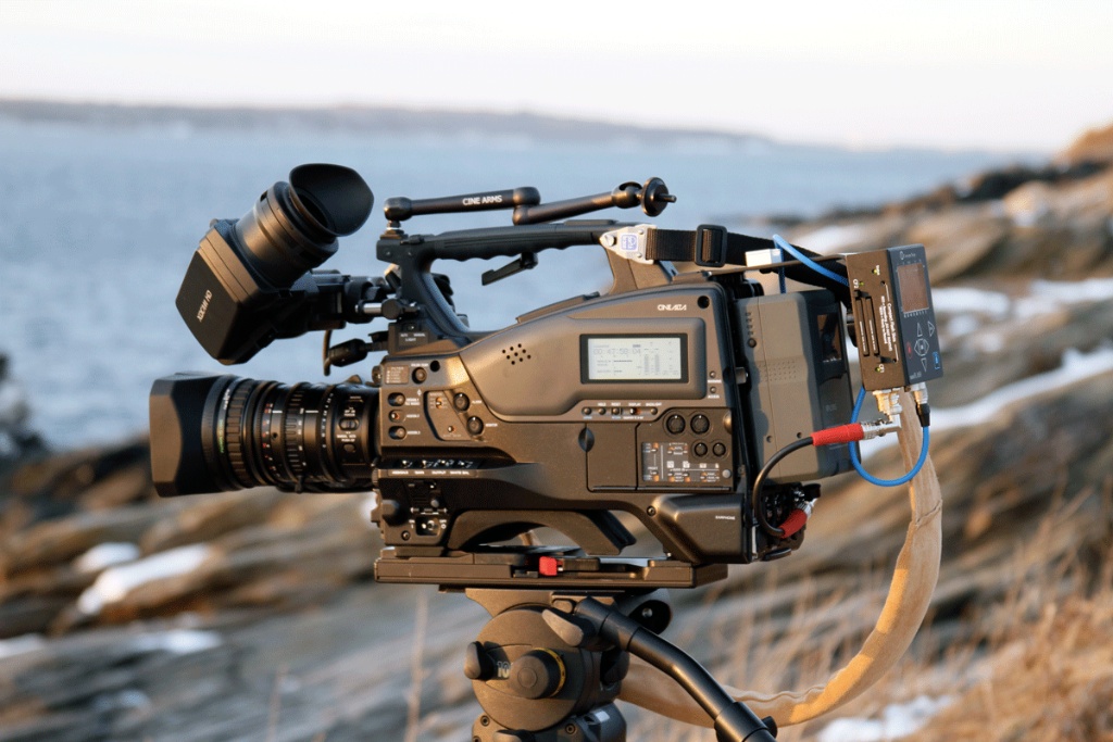

Chris, here is a higher res photo of Paul Cronin's setup on a 350, there is plenty of room to remove the battery.
He is now using the same setup on an 800 w/o problems.

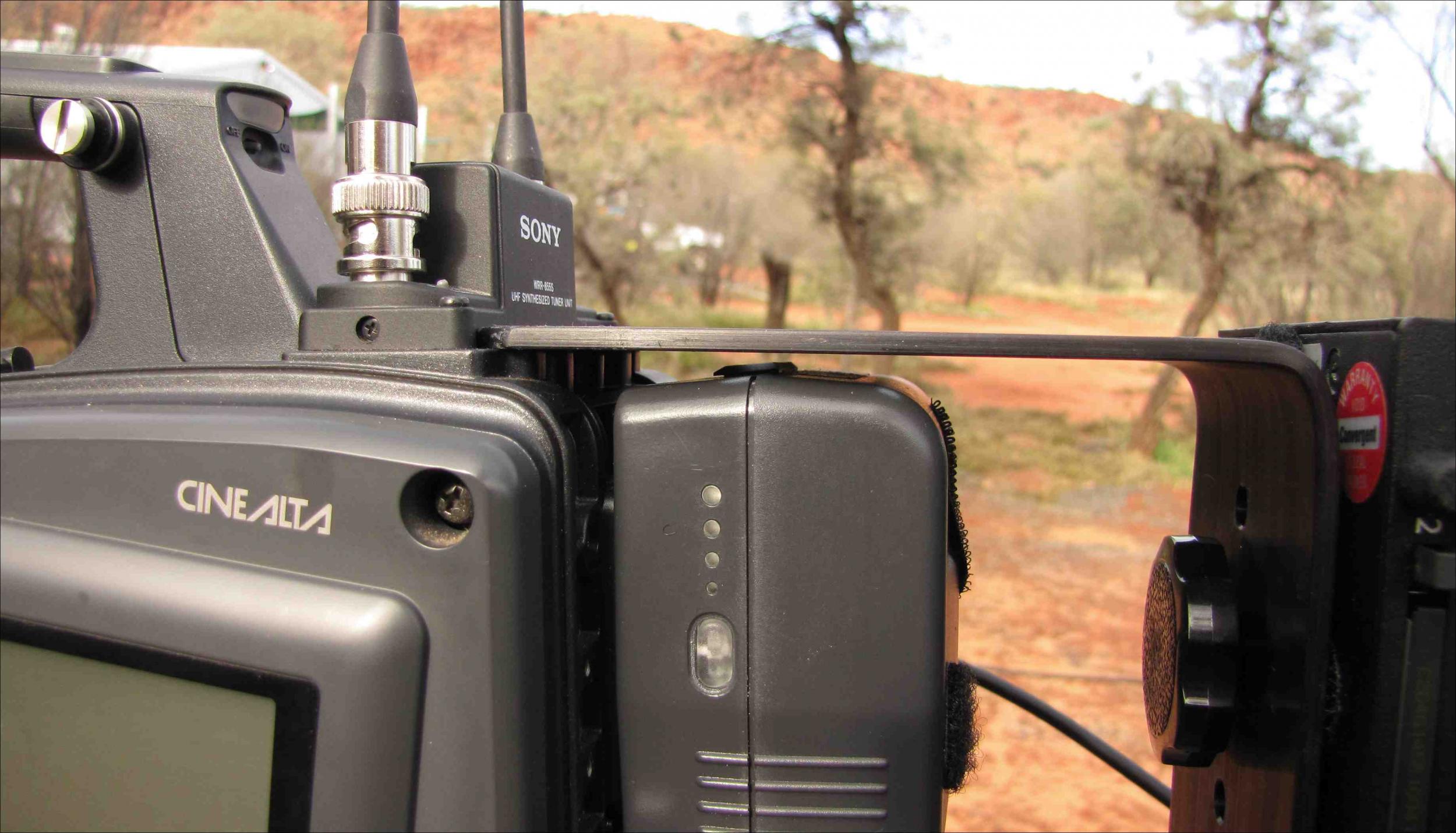

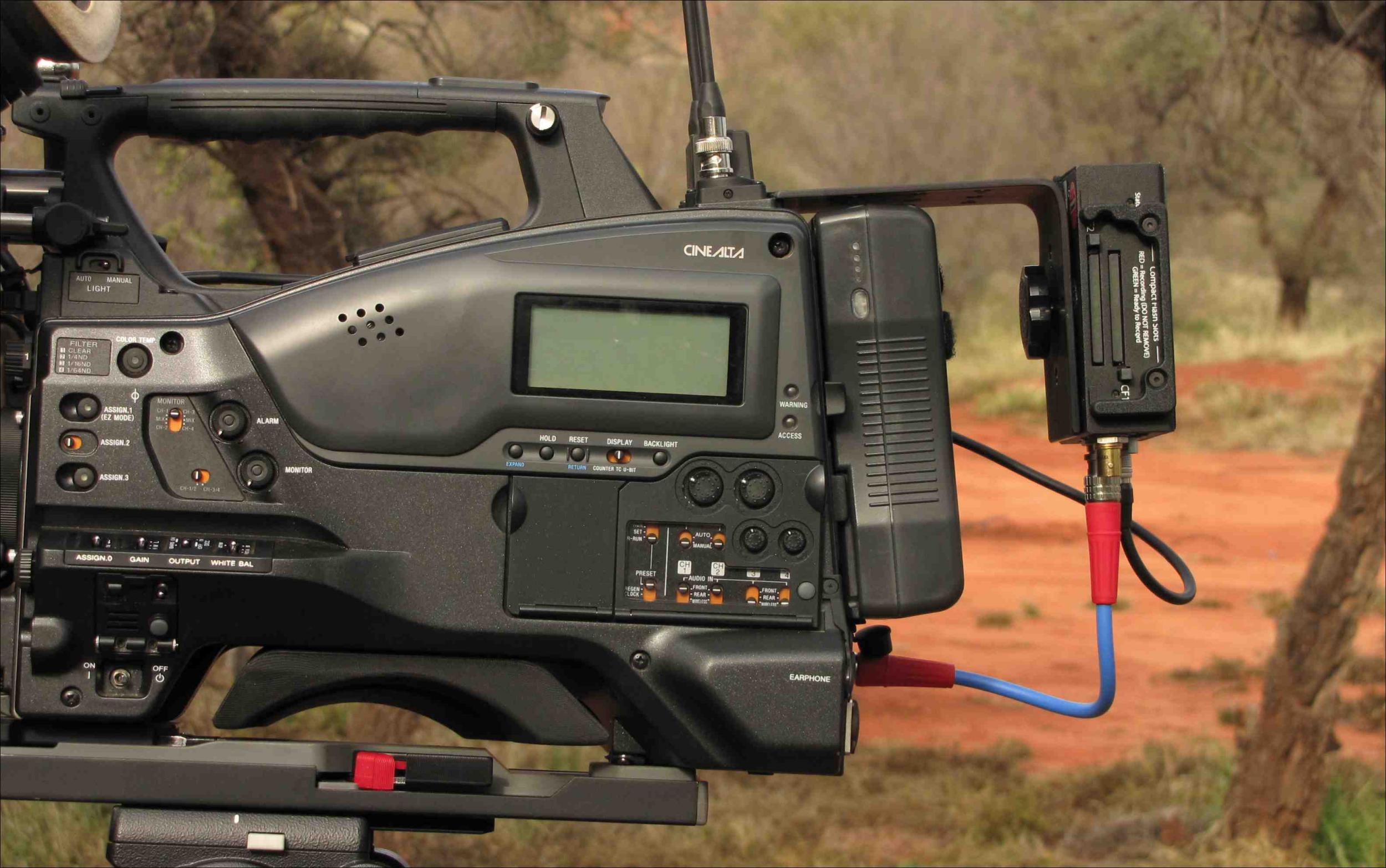

Olof, Paul's gap between bracket and battery seems to be about an inch, unfortunately mine, as you can see, is more like 1/4" from the d-tap rubber hood, so I cannot remove it. Also the supplied silver screws simply fall loosely all the way into the outer holes, there is no thread contact. Maybe there was a mix-up with other screws? Thanks.

The 4mm screws are far too thick and the supplied screws just touch the sides when in the holes, so
I would suspect you're on the right track, but can't really advise more. My suggestion would be to try and mount a locking hinge very close to where it screws on now. In other words the hinge flips up to allow access to the battery, but then locks back in place with gravity when it's down. But maybe I should just stick to camerawork too!
In terms of upward movement it actually doesn't need much to release the battery, maybe just 12mm, but that's just release, of course you need some manouvering room under the bracket as well, so I think 25mm. Only thing that might vary that is if people are using the d-tap on top of the swit, that adds a bit more. I use the on camera light d-tap on the side of the camera myself. Happy to beta test, but couldn't skype last time I tried (combination mac and satellite broadband issue). I get really cheap calls though through Jajah so can just do that. Probably be tomorrow morning your time though. We are + 9.30 GMT so what time is best for you?
