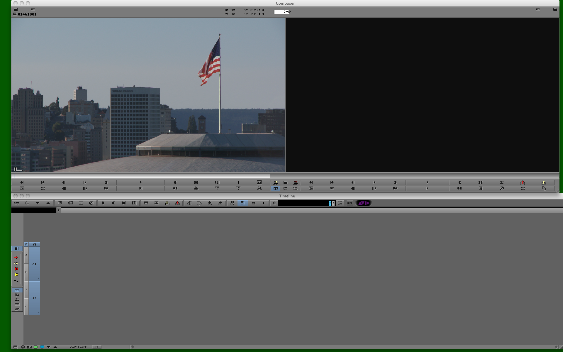

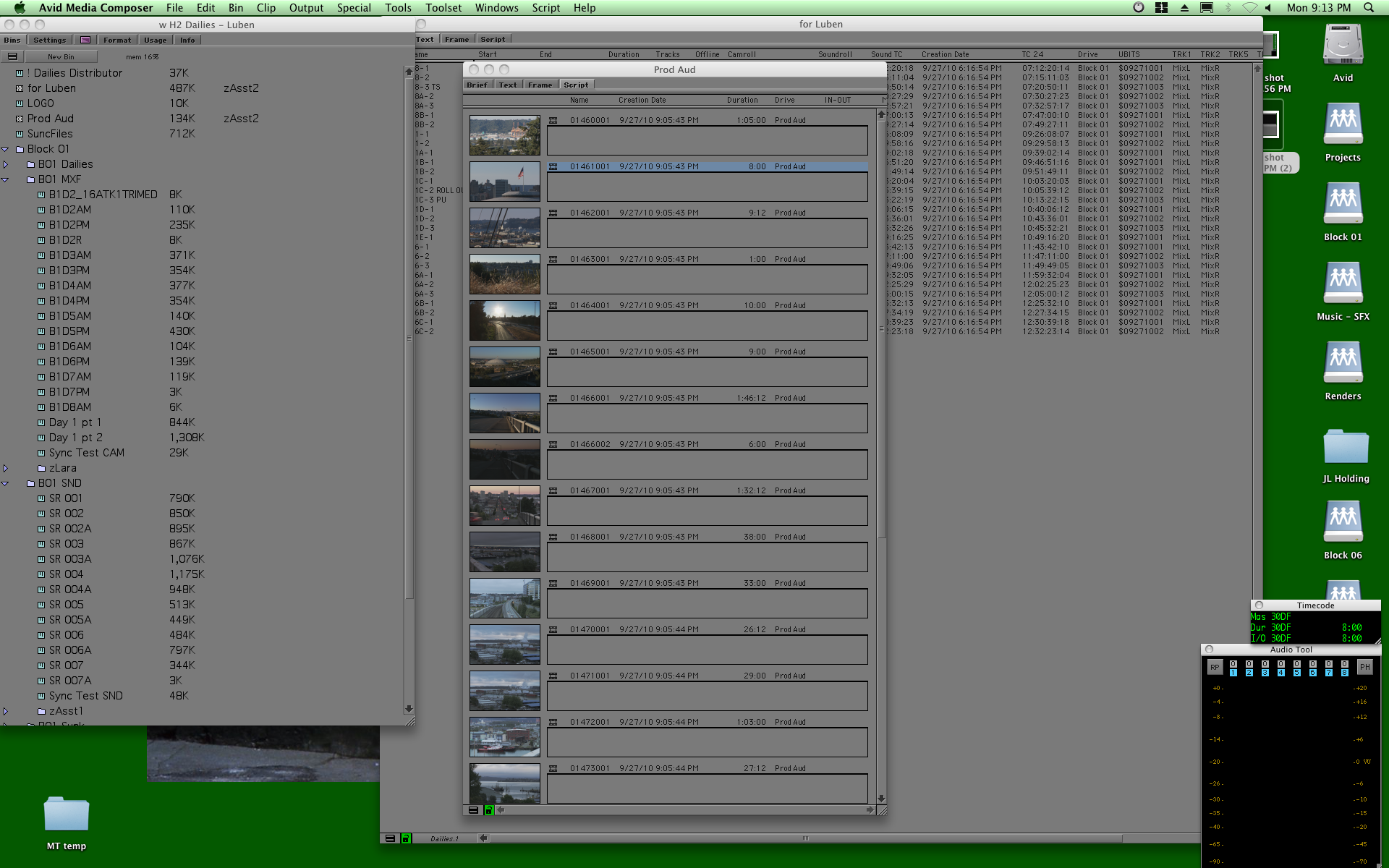

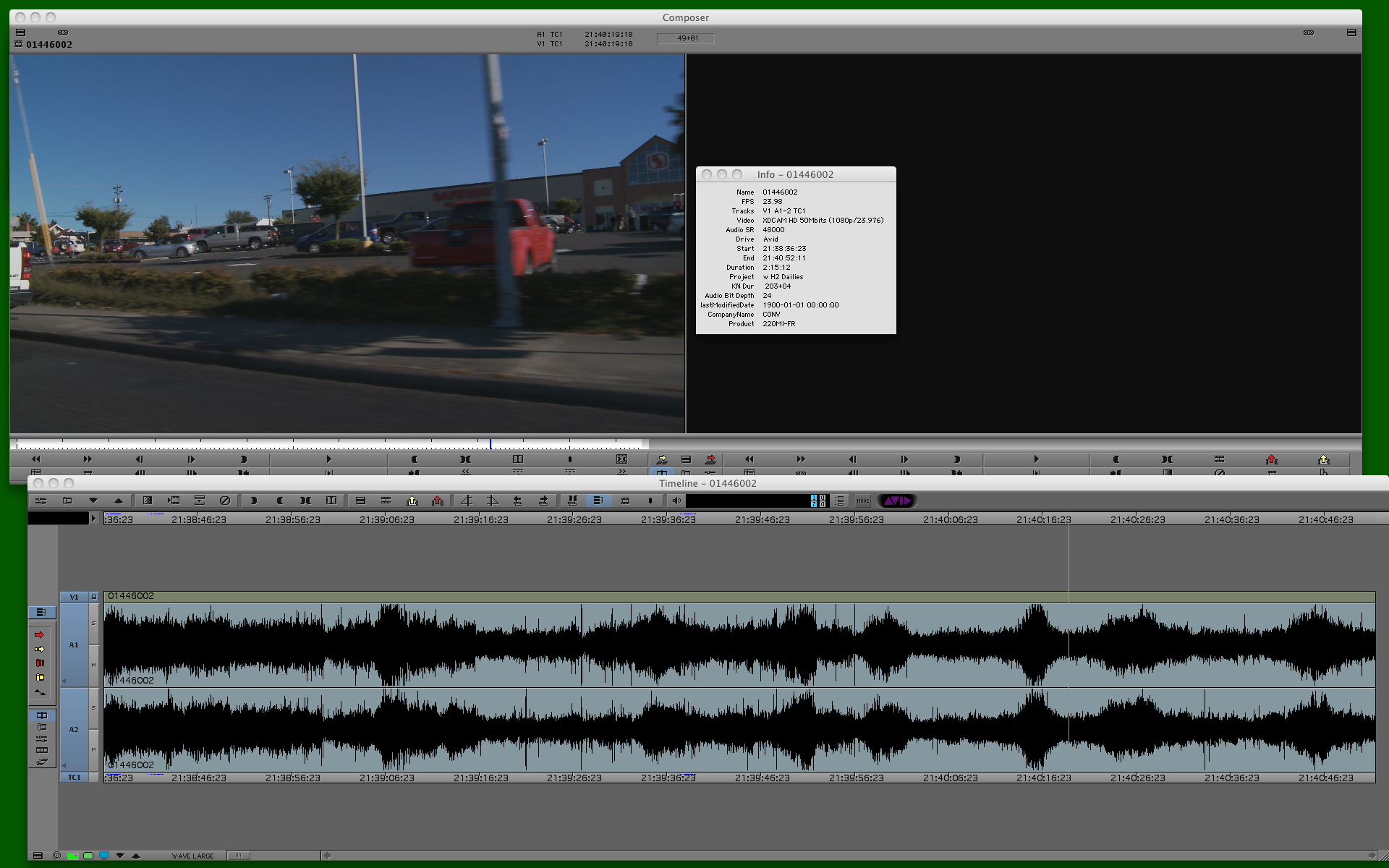

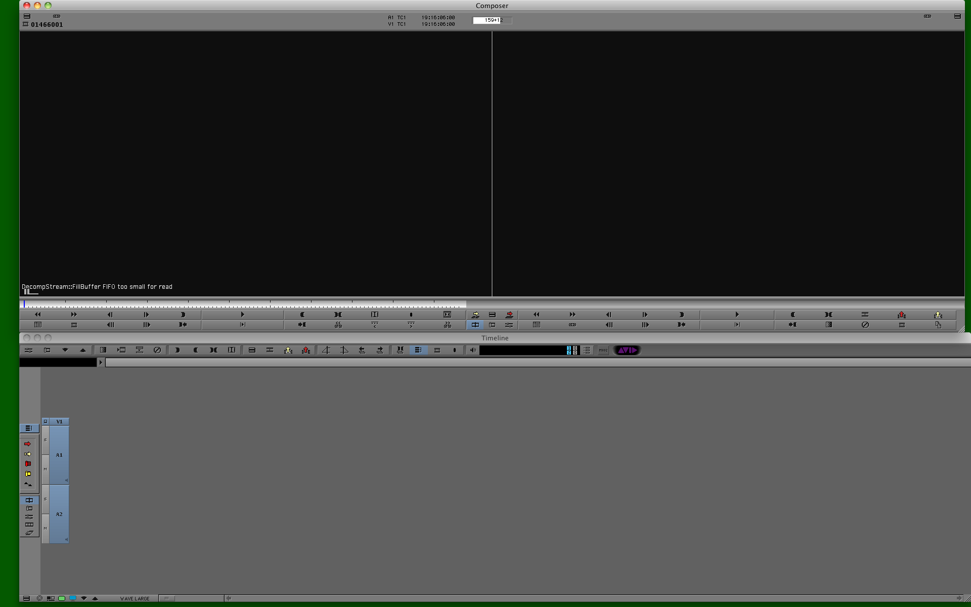

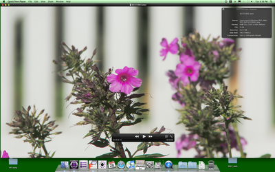

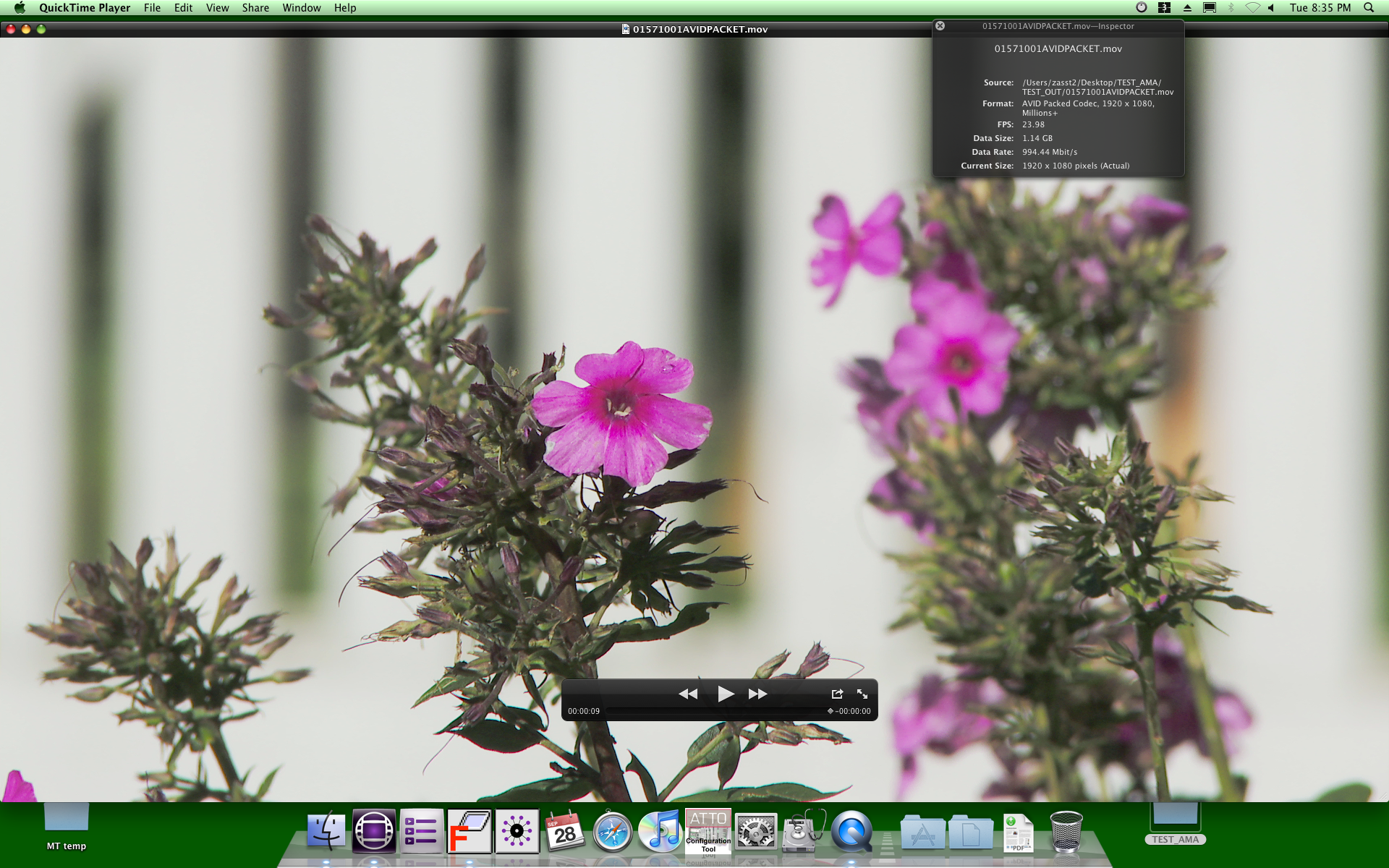

I have 5 AVID MC5 in my possession right know and all got the 5.0.3.2 update today and the feedback would be that all of the bit rate files (50-280 MBPS) went linked on a blink of an eye to the master clips. 50-180 MBPS played with sound when available without any problems at all. Was a magic.....
The files 220 and 280 ware imported but I couldn't play them. The error I got was FIFO too small! I can see the picture in script/frame view, but can not play them. All of the AMA clips had info of 50 MBPS
All of the info is in the pictures below....
I am on a 12 core Intel and 16 GB RAM
I didn't convert the QT to MXF files... it should be the same.... that why AVID came with AMA option
Hope this helps
Cheers

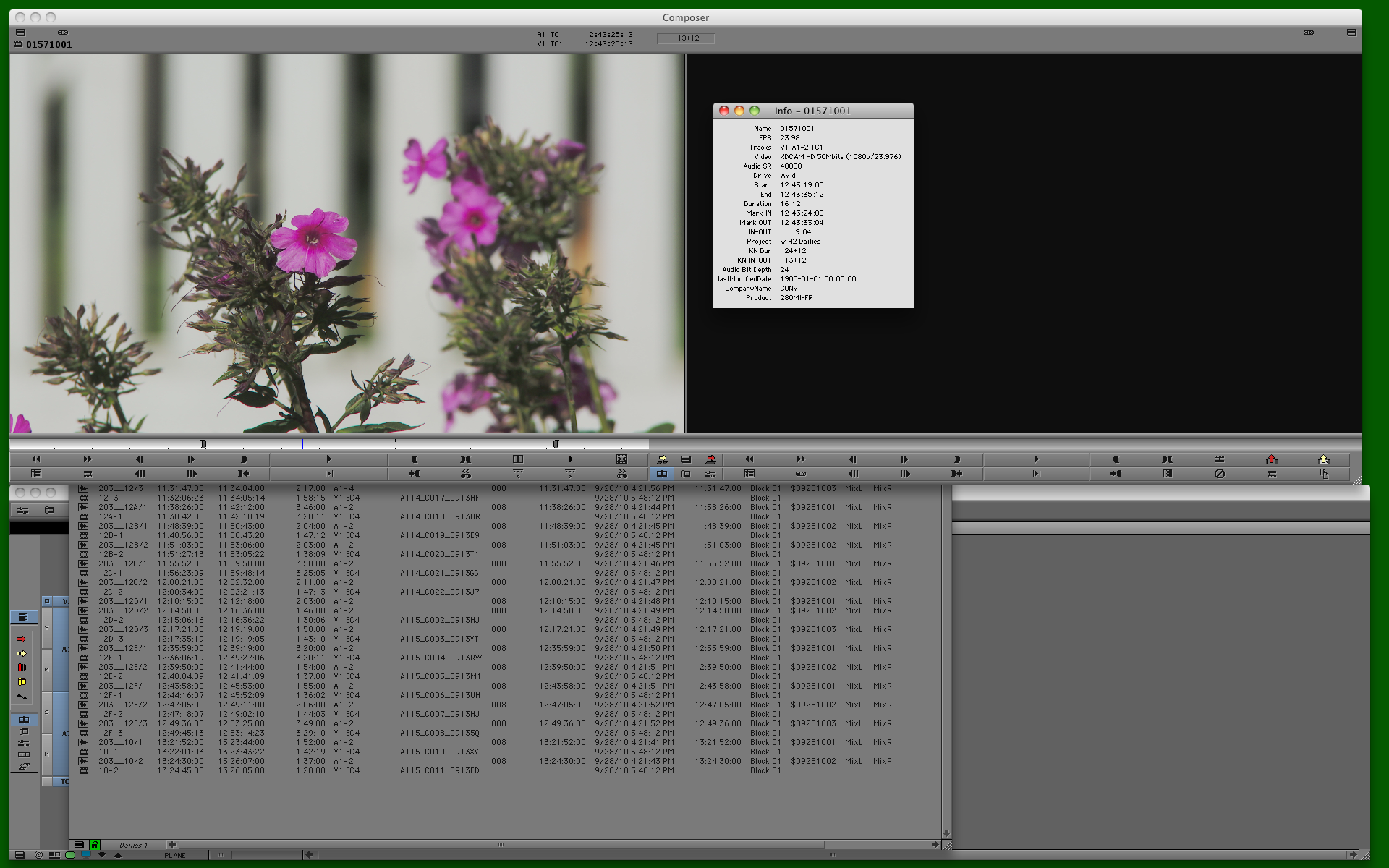

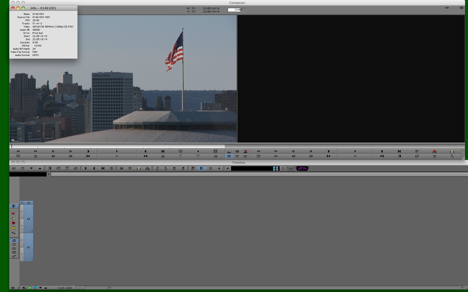

Just before I go home I said to myself ...." ...not fair to MXF files...." so I converted 1 file 280 Mbps and 1 file 220 Mbps from QT to MXF using the latest File Converter for Mac from CD and the fact is that - AVID HAS NO PROBLEM IMPORTING AND PLAYING CONVERGENT DESIGN NANO FLASH MXF FILES IN ANY BIT RATE"
Below is a grab from my AVID screen on 220 MBPS file (in motion) with info window on the side. You would see that everything you need to know is in that window! BRAVO AVID!!! BRAVO CD! YOU DID IT!
My apologies to all, but, I can't show you the 280Mbps file, simply because is not mine any more. I sold it to a production house in NY.

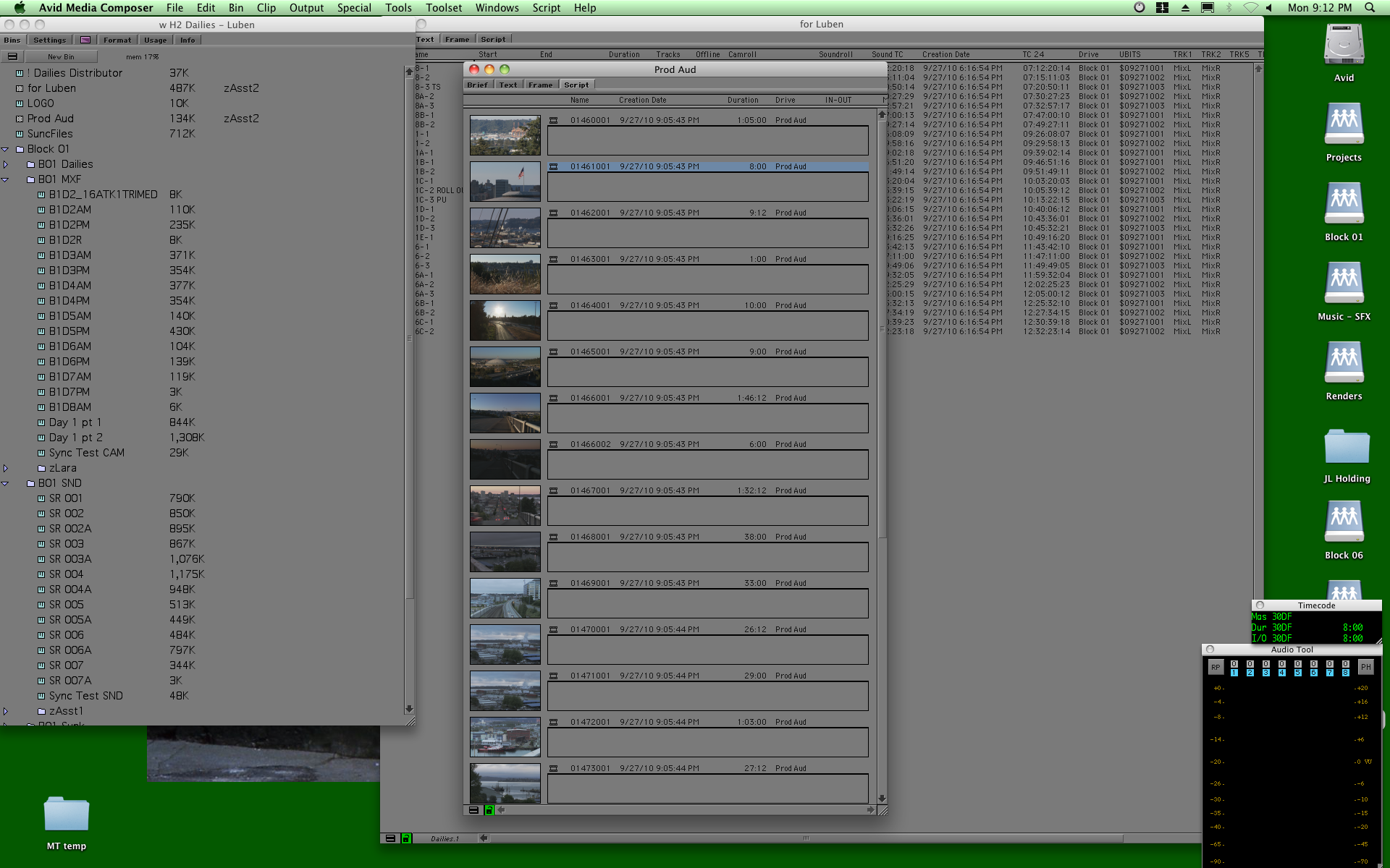

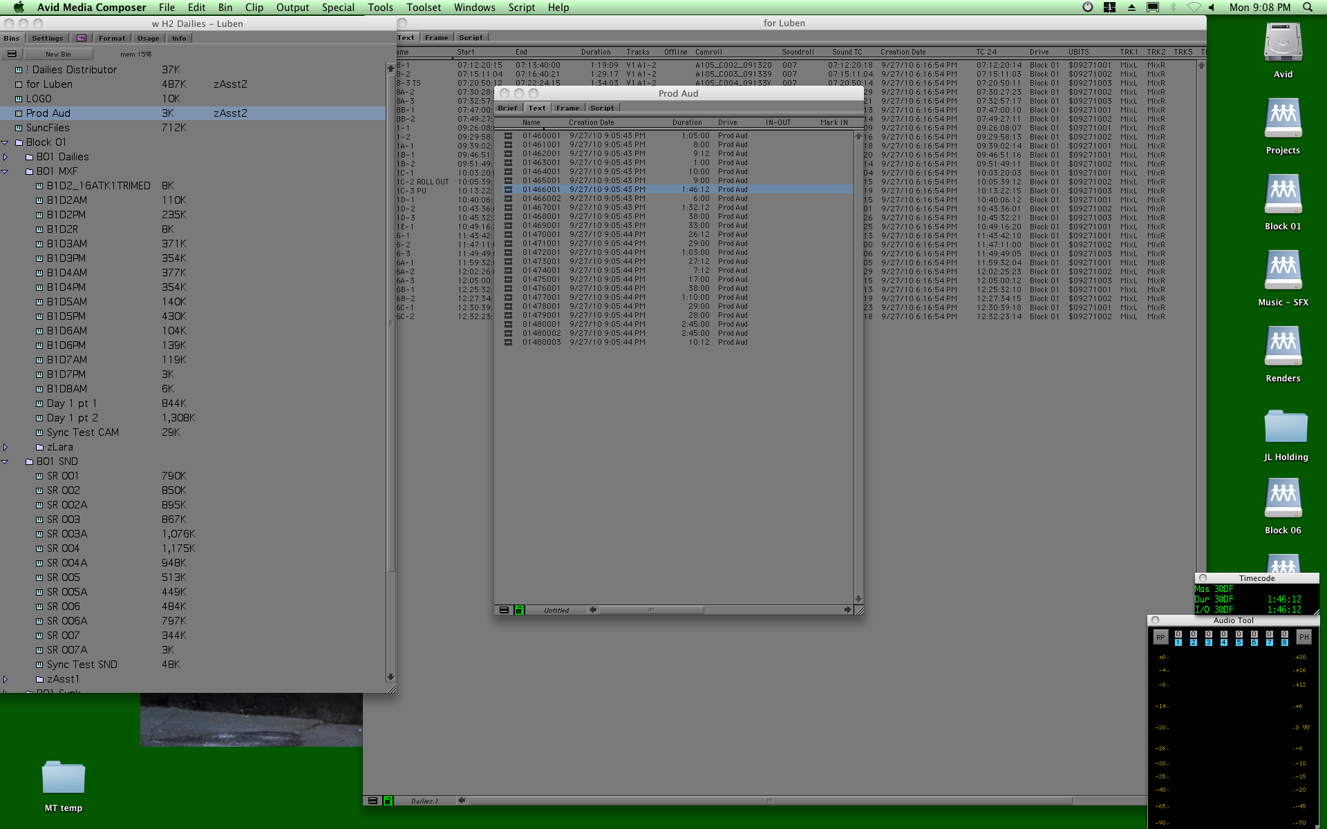

I was very busy so far today, but hopefully with the day progressing I'll be able to do what your asking. I've shot few 280 Mbps clips early this morning so that I don't compromise anything....
to be continued....
The first picture is from the AVID with info window showing the data of the file - on the bottom is the bit rate 280M I-FR
The remaining 3 pictures are grabs from 3 different outputs from the AVID with info window on the side. You could see the bit rate and what kind of file they are.
Conclusion:
no problem at all
Hope this would help anyone regarding AVID and CD NanoFlash files relations.

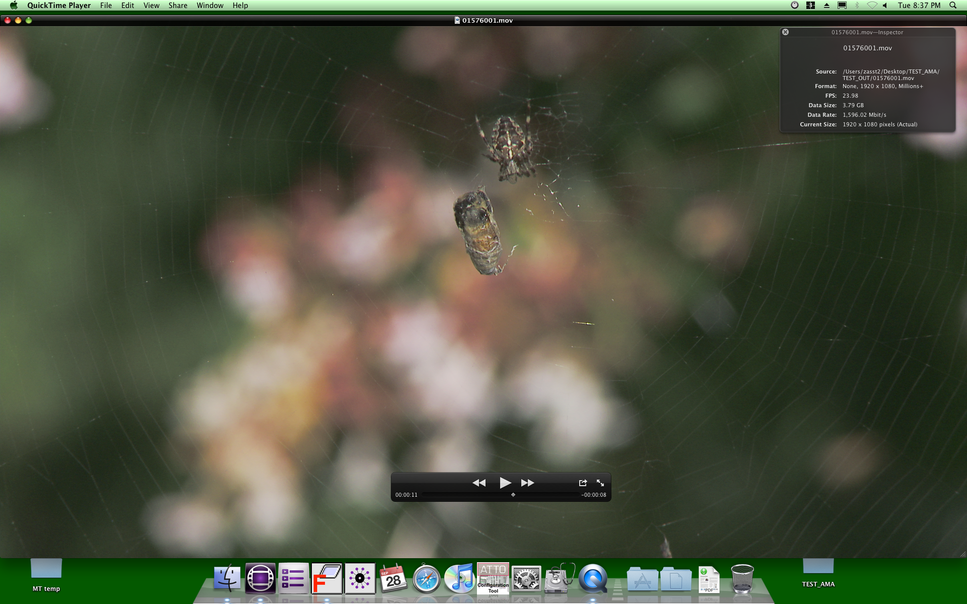

from AVID MC5 8bit Uncompressed
all this files ware NF files 1920x1080p 280Mbps imported to MC5using AMA and exported 8bit Uncompressed, then compressed to H.264 1280x720 for Vimeo
I know its boring, but hope it helps.... ;-)
