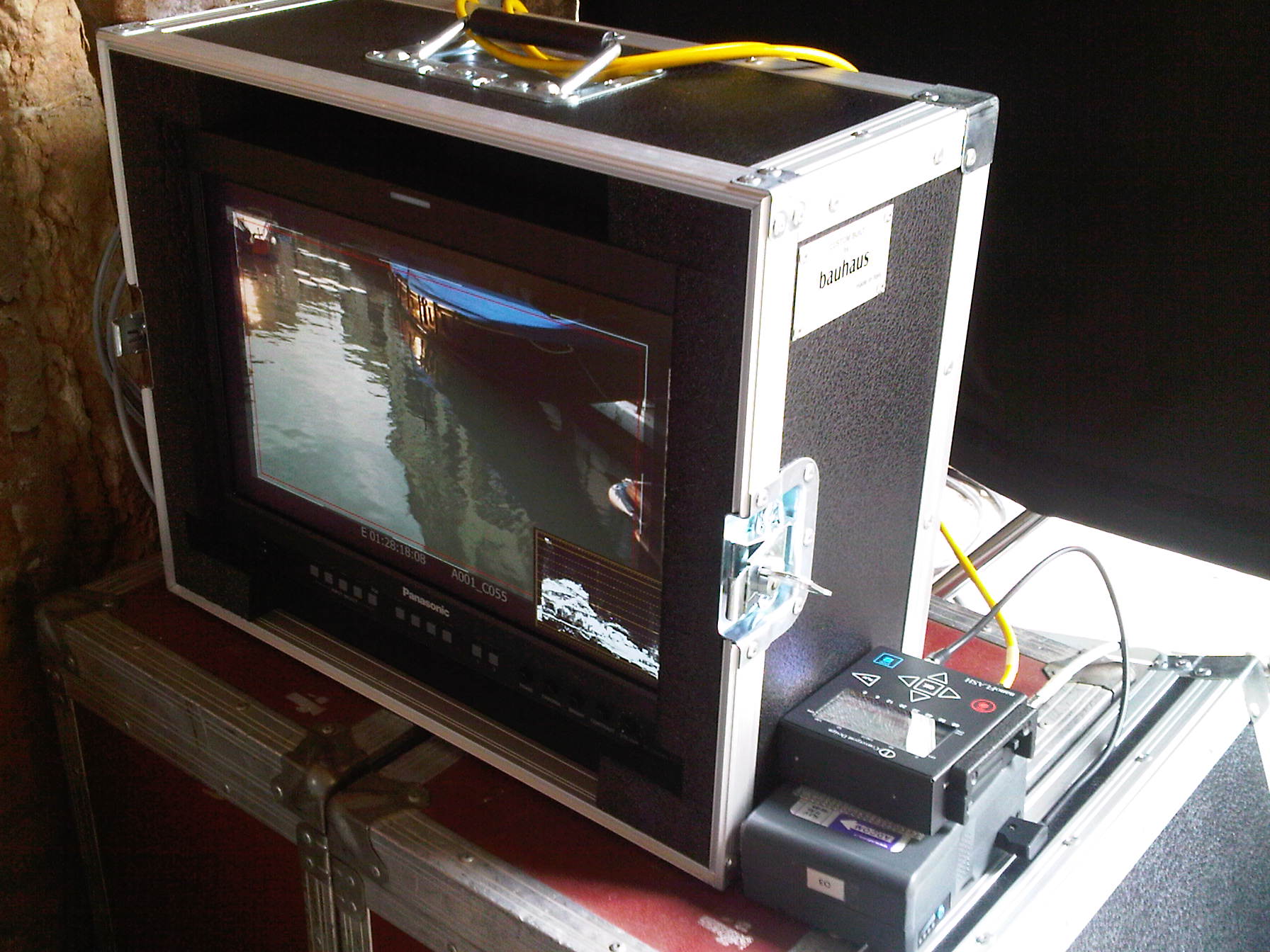

I just love my nano flash,here’s a picture of last time use.video assist…
