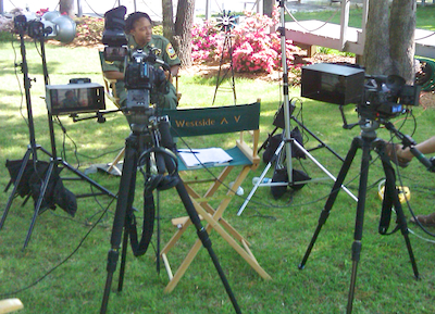

Below is a cell phone photo of an interview setup where I run 2 cameras from one position using the remote cable, also note the 2 monitors for checking frame. This is a very comfortable way to record for hours on end running 2 cams.

The EX1R (B-cam) on the right has a NF with remote cable (including Tally light). I just run the cable over to the EX3 on the left. That camera is triggered by the Remote button from the lens, on the tripod arm. I just tape the EX1R remote NF trigger to the arm as well, and push both buttons if I want to record with both.
I often use only one of the cameras for a while, to record discussions with the talent, interviewer, producer, director myself etc. for the record. But I can instantly trigger the other cam as well w/o moving. It is also nice to see the tally light on the trigger cable.
I am standing or sitting at the camera on the left, during the shoot. I can this way monitor and run both cams very easily.
I also always place the talent in the shade (natural or scrim on a stand), I then light to match the sunlight. This way the exposure stays the same on the talent if the sun goes behind a cloud. So I don't have to change the exposure on the cams. I frame the B-cam wide. And adjust the A-cam if I have to.
This system works well if the budget does not allow for second cam operator. I do a lot of these interviews and we sometimes interview 8 or more people in a day, so the days get long. It is nice to be comfortable, it keeps you more alert.
