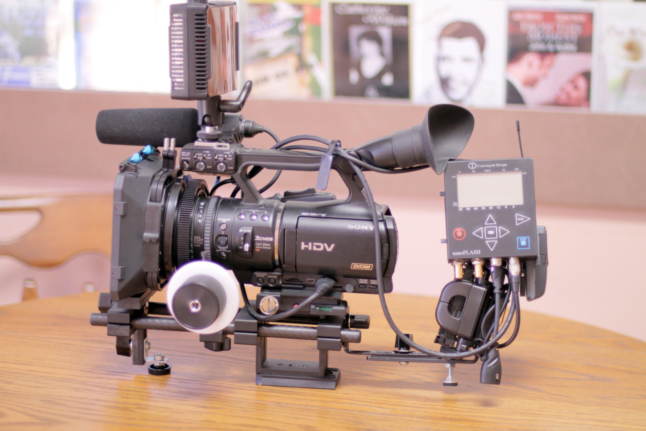

Your question is not dumb. I have a V1 also, I added a Nanoflash to extend the life of the cam. I have been happy with the results. I also was considering the EX1 after some research I came to the conclusion that you would have to add a Nanoflash to the EX1 also, so I went with the Nanoflash. I figure that a lot of people will be jumping to large sensor cameras and at some point those cams will end up on ebay. I will wait for a good price on an EX add my Nanoflash to it and be in good shape.

Ron, nice looking little rig!
