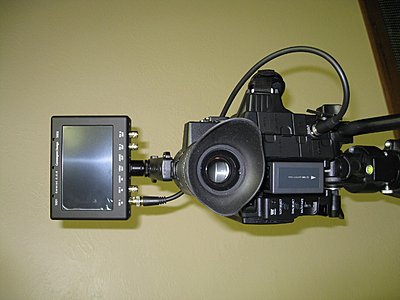

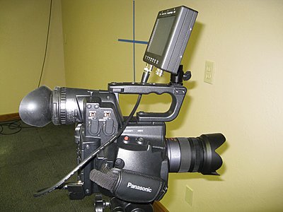

Quick Photos of Gemini Mounted on Camera
Here's a couple of quick photos of the Gemini mounted on the side of the AF100. We're still waiting for our F3 to arrive, but this will give you a good idea of the size of Gemini. It's just a little larger than a typical 5.0" LCD monitor.
Official: Convergent Design Gemini 4:4:4-gemini-af100.jpg   Official: Convergent Design Gemini 4:4:4-gemini-af100-side.jpg
