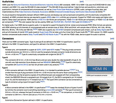

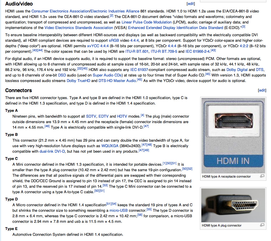

Peter, I stand corrected. The HDMI spec has evolved and continues to adapt to work with 4K and 3D signals. Unfortunately, so do the connectors types that are required to support these higher data rates. Wikipedia has a good summary on the HDMI evolution and I have attached a graphic showing the 5 types of HDMI connectors.
For field work, the SDI standards and BNC connector would be the preferred connector for reliably transferring high data rates off a camera and into a portable recorder.
