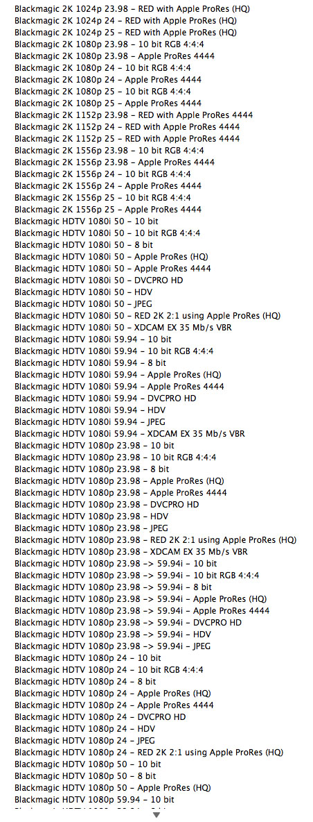

Can you explain your statement that Final Cut Pro "editing Uncompressed won't allow maintain the quality through the editing process"?
FC works full Uncompressed (444 time-line) and when rendering required does it at 32b FP.
Can you point to the problem?
rafael

Lance, FCP has since version 5 been able to edit uncompressed HD footage. When you purchase the capture device the drivers come with it. I have been using a BlackMagic Design Multibridge and as you can see in the attached window capture, the drivers and corresponding settings are all there. I currently use FCP 7.0.3. As mentioned elsewhere in these threads, you will also need a wicked-fast RAID array to edit uncompressed whatever.
Gemini 4:4:4 feature request - compressed codecs-fcp-hd-2k-uncompressed-timelines.jpg
