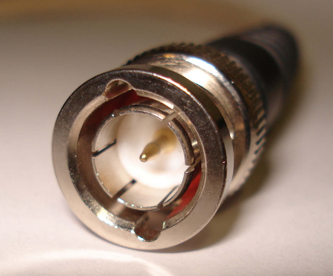

I have this HD-SDI cable Dan, is it a 50 Ohm cable?

Don't know about the cable :), but the connector is the correct 75 ohm type.

Re: prob with nano
Billy
:) Thanks Billy, thats what I should have said.

Dear Anthony,
Yes, that is a nice image of a 75 Ohm BNC connector.
