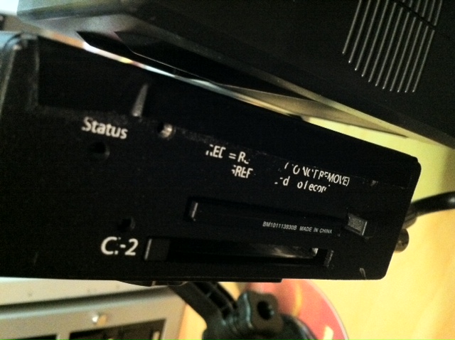

A similar thing happened to my new Nano. The soundie taped a radio mic around the nano bracket and partly taped over the letters and ripped the letters of when the mic was taken off. I was pretty hacked off as thought it should have withstood a bit of tape over it. Looks pretty crappy now :(
Dear Tim,
I am very sorry that this has happened.
Here is the cause of our problems with the lettering:
The letters are screen printed.
The powder-coat surface of the nanoFlash is not smooth, as we chose a textured surface coating.
This was a mistake, as the silk screen letters do not get good adhesion to the surface.
Since you are in New Zealand, shipping back to the US is relatively expensive.
Please contact me if you ever need your unit serviced for any reason. I will try to remedy the situation then, or if you want to send it in, just contact me.
