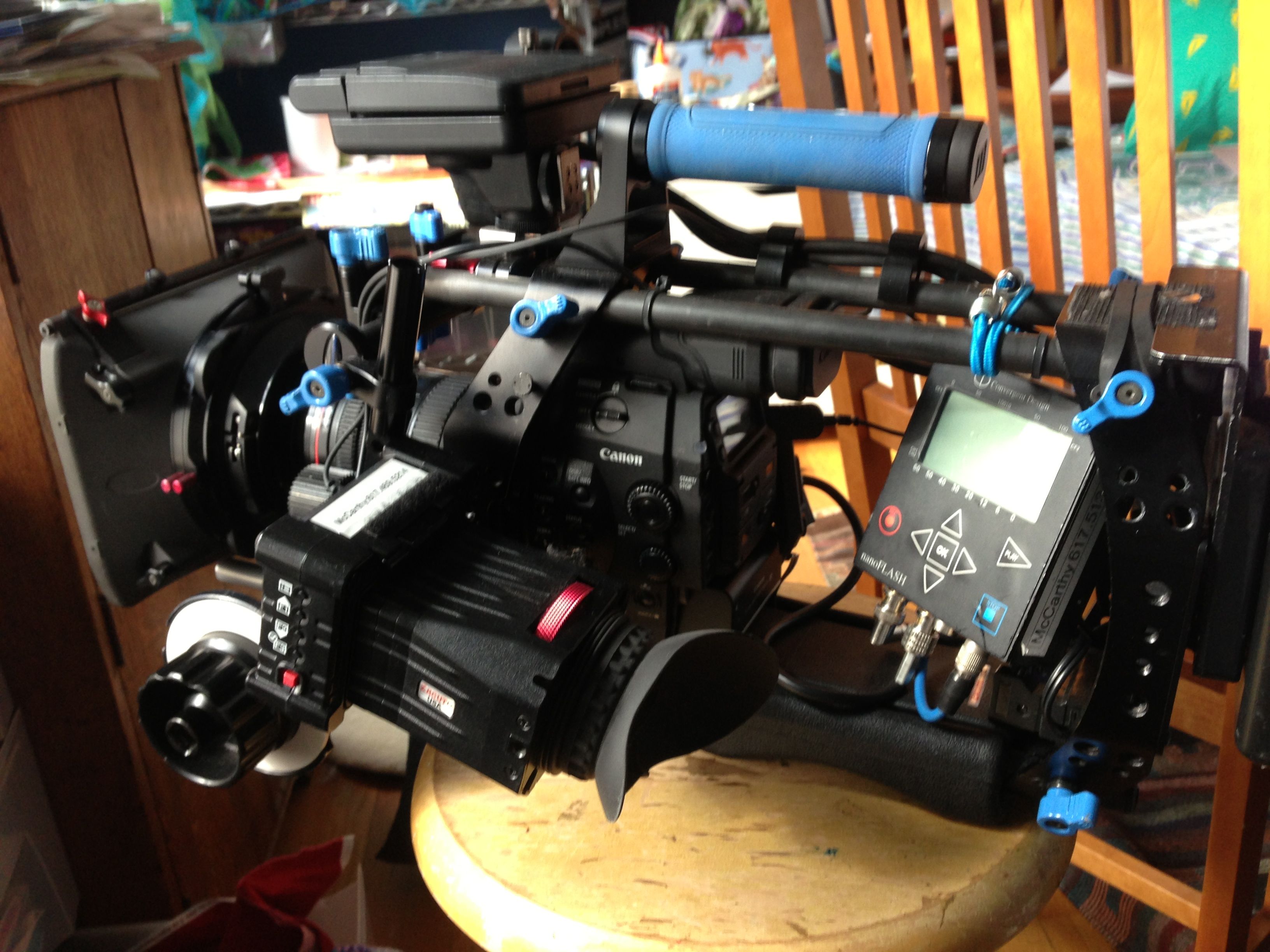

Hi All. And still, the discussion continues. Flattered to have such esteemed consumers of gear participating. With all of the talk about ergonomics of cabling nanoFlash to C300 I thought you might be interested to see the design that I've evolved for my camera over the past year. Just a quickie photo on the go but the layout's been serving me well.
cheers,
Stephen McCarthy
