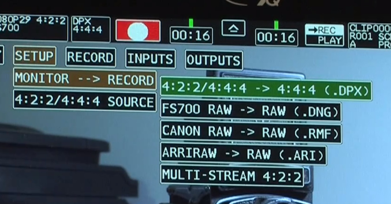

There is a mode, I have to check what it is that works right now. I think it is called multi-stream 4:2:2 mode.
I know you can get 2 HDSDI in and display WF's for both below each input. It does not work with HDMI yet, but will. I have seen that working.
I have not tried 4 inputs yet, but I can. Time is my only constraint, I will try later.

Your picture shows exactly what i'm doing - Multi-Stream 4:2:2

The Multi-Stream mode, under the Setup Menu, allows one to monitor up to four HD-SDI inputs.
Each input has to be HD, 1920 x 1080, and the frame rates can be up to 1080p30.
Different frame rates are supported, for example, one could be 1080p23.98 and another 1080p29.97.
In this mode, Raw, or other special modes are not supported.
If you connect two cameras, one to SDI A, and one to SDI B, you will see two side by side images.
And you can also connect SDI I/O to a third camera and SDI-I/O B to a fourth.
At this time, this mode does not support HDMI input, but this will change.
The Demo mode message does not really apply, as this is a feature built into the Odyssey7Q. This message will be removed as soon as possible, I am expecting it to be gone in our next firmware release.
Later, we will add an extra cost option to allow multi-stream recording.
At this time, our Multi-Stream Monitoring feature does not support recording.
