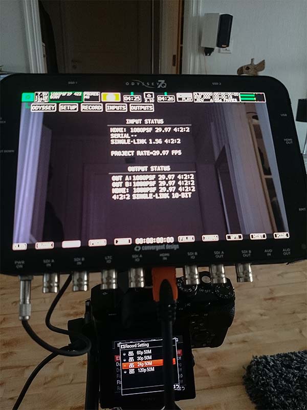

Trying out the A7S with the O7Q.
I get picture, but I am struggling with a few things, quality and frame rate.
Is the A7s yet supported officially?
From this table I assumed the A7s is supported:
https://www.convergent-design.com/pr...y7q.html#setup
Anyway, when I use 24p (23.976) on the A7s, it is detected as 29.97p, see attachment.
And I can find no way to set 23.976p manually on the O7Q?
I have tried different settings on the O7Q, from FS700 to other Sony camera.
Prores video in SLOG2 seem to be "graded" and look more like 709.
When using other profiles like Cine2, the picture look very bad in shadows and dark.
Will the O7Q only support SLOG2 from theA7s? (This is a question CD should be able to answer already now regardless of status/progress on the A7S+O7Q marriage)
BTW! An update on progress on A7S+O7Q "4K/UHD path" is welcome :)
Ole
EDIT: Oh I see the 32 under the setup menu, probably means 3:2 pulldown in O7Q to acheive 24p ??

Dear Ole,
1. Yes, if your camera is outputting 23.98 or 24.00 with 3:2 Pulldown frames added, then you should go into the Inputs menu and select the option to remove 3:2 Pulldown.
If you camera is outputting 23.98 or 24.00 and you see the Odyssey7 or Odyssey7Q reporting 29.97 or 30, then you need to set this option.
The unit will then search for the 3:2 Pulldown Frames and remove them, and then report the proper frame rate.
Note: Please be certain to ensure that viewfinder data is not being output to the Odyssey7 or Odyssey7Q as this interferes with us detecting 3:2 Pulldown Frames.
Also, please ensure that color bars are not being output either, for the same reason.
