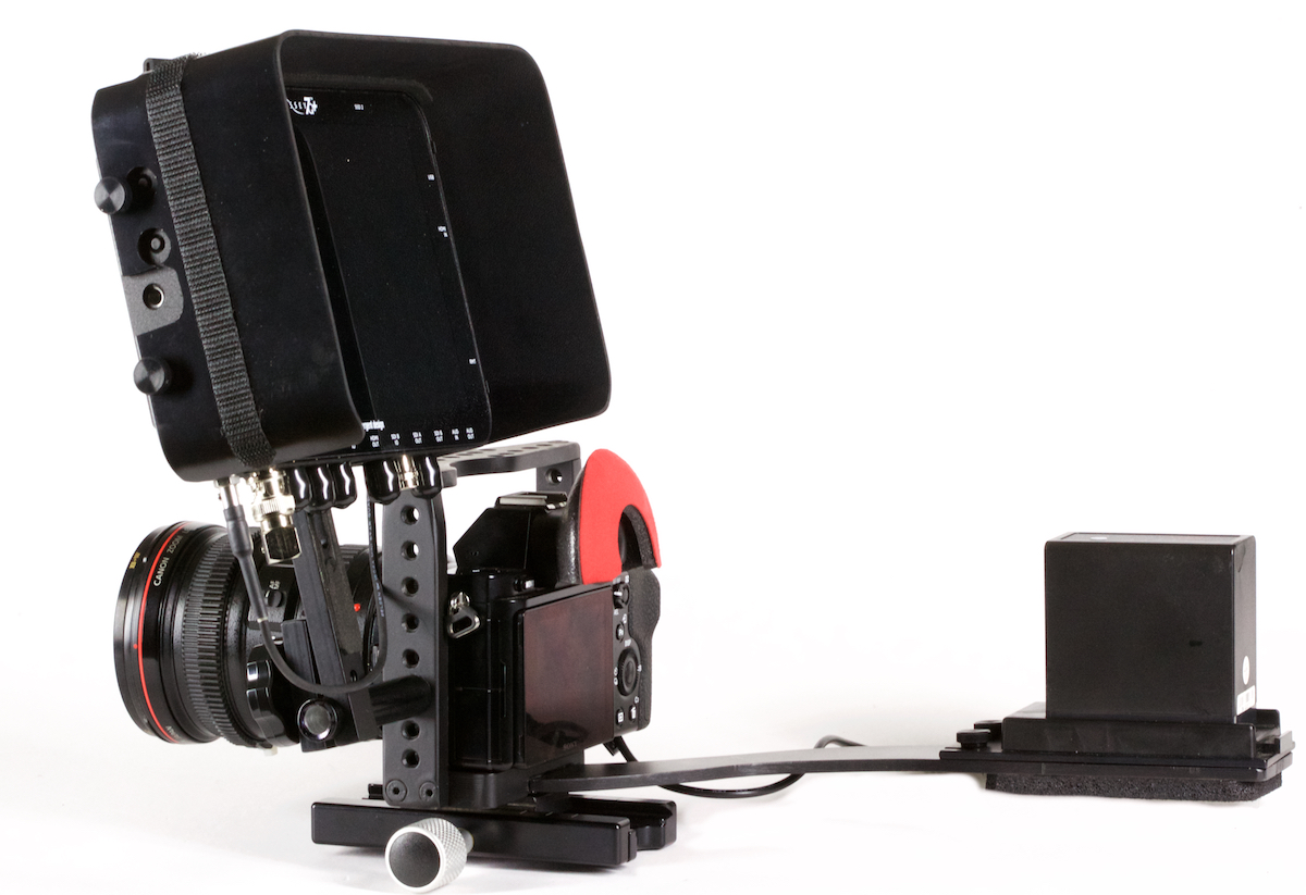

Here is how I do it on a A7s, this is on the cage I make, but it will work on any rig that has ¼-20 tapped holes.
More info on my webstore:
Westside A V Studios WEB Store
The 15mm system for mounting the Odyssey is very versatile.
Sony FS7 Odyssey Mounting Bracket
This shows it on a FS7 but it can be used on any camera.
Here is a link to my Odyssey battery plate:
Odyssey Battery Mounting Bracket Westside AV

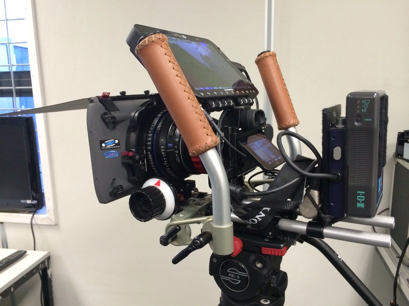

I use standard materials with 15 mm rail support
Cute package with mean features
Now i can also add remote follow focus etc.
