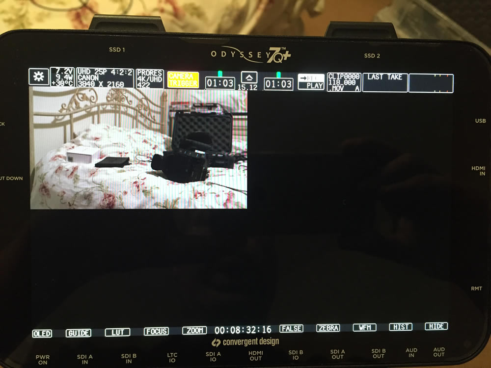

Hi.
Just got my C300 mk2 and connected it to my 7Q+.
When in UHD 3840 x 2160, it only shows on a quarter of the 7Q screen.
I'm connecting via SDI A.
HD outputs are ok. it's just UHD and 4K
Any idea how I can make it go full screen?

Typically this happens, when you are in a UHD (Ultra-HD) or 4K mode, in the Odyssey7Q+, but are only sending a HD image to the Odyssey7Q or Odyssey7Q+.
Thus, I would like to help you personally, to troubleshoot this problem.

Dear Syeed,
On the Canon C500, 4K and UHD are output via HD-SDI as Raw only.
(I am about to read the C300 Mark II manual to see if the C300 works the same way over HD-SDI).
If the above is true, then:
You have your C300 Mark II setup to output UHD, over HD-SDI which is Raw.
But, your Odyssey7Q+ is setup for taking 4K/UHD 4:2:2 (video) from HDMI or HD-SDI sources.
Please go into our Setup Menu, in Monitor-> Record and select:
Raw -> ProRes or
Raw -> Raw
Do you have our Raw Bundle, and is Canon Raw installed.
Please call me, I provided my numbers I my previous Post, above.

Dear Syeed,
On your C300 Mark II,
In the Record Media Setup Menu,
In the 4K Record Out Raw Mode,
Have you selected 4K Raw, 2K or Off?
I believe that you have to select 4K Raw to output UHD.
Then on the Odyssey7Q+, press the Gear Button (in the upper left hand corner),
Press Setup
Press Camera or Master Camera and select Canon (which you have already done)
Under Select: Monitor->Record:
Select Canon Raw 4K/QHD -> Raw (.RMF) or
Select Canon Raw 4K/QHD -> ProRes (.MOV)
Please note: to record Raw to Raw or Raw to ProRes, you need our Canon Raw option, which is part of our Raw Bundle.
If you do not have the above, then you can setup the C300 Mark II for 2K output and then record 2K in the Odyssey7Q+.

Thanks for the telephone help Dan.
Have installed the RAW upgrade and everything working now.
