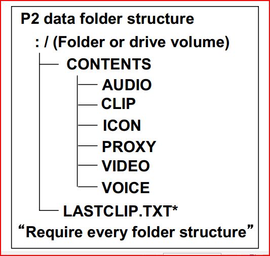

Not just his opinion. Worked for years with Panasonic P2 Atom based MXF and saw and experienced quite a few problems. Once we moved to Sony OP1a MXF with its single file structure our problems dropped by about 90%.
The main issue was not in the acquisition stage it was in the subsequent handling, transferring and copying of the files between work stations, servers, editors, drives etc. Seven items per folder per clip. If you lost or corrupted that LASTCLIP.TXT belonging to a clip then you were really battling to try and reconstruct that particular clip. A short clip you may get away with losing it but if it was a half or quarter of a football game... oops!
It became a big enough issue with enough broadcast P2 users that Panasonic eventually issued a document called: "Important Notes at P2 content Copy" I still have it! See attached. The last bold underlined text warning at the bottom of page two was a warning to people not used to working with Atom based MXF.

Any news on DNxHD and will it be MXF?-p2-structure.jpg   Any news on DNxHD and will it be MXF?-p2-structure-02.jpg

Noa I guess what it comes down to in my experience is that in the P2 Atom structure there are just so many files per folder as opposed to OP1a's single file. Sure I have seen corrupted OP1a and when the file is badly corrupted it is almost impossible to recover.
I've see operators take great care in transferring P2 folders and end up with more failures than expected. I think it's down to the fact that with seven files per clip you have more chances of one of one of those seven items having an issue than with the one file structure of OP1a. Just my theory.
What I do know is if that LAST CLIP.TXT file is corrupted well then you have lost the entire information structure of that folder contents and have to rebuild the LAST CLIP.TXT file. Plenty of info out there on how to do the rebuild. Totally possible but it means you have check out the video files to get the clip info plus the number of video files in that folder plus there are issues if the clips have spanned two cards. Just one hell of a lot of mucking around while chewing up time.
