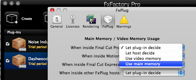

FxFactory utilizes the graphics memory to speed up renders. You may get different results if you adjust the FxFactory preferences to force the use of FCP's RAM instead. I'm on the road so I can't test this on my Mac Pro for a few days but I will see if the FxFactory developers have any other suggestions.

Ok, I changed it and it works now...very slow, but works. It took 30 minutes to render a 50 second clip. I hope there will be some maximisations in the use of the graphic card. BTW, my system is a 8core, 3GHz, 4G RAM, and a 8800GT, so its not the slowest one:))
Before I forget, the "red stereo3Dtoolbox box" went away after the rendering.
