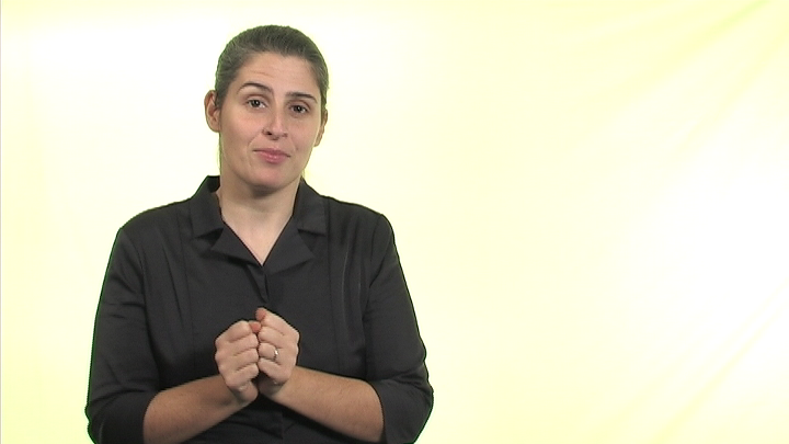

If you wouldn't mind, could you post (or email) a frame from the greenscreen shot, and the background? I'd like to give it a whirl in dvmatte.
I don't have a shot of her out of frame. But here's a screen grab without the Luma Key applied. I intentionally tried to get the background as hot as possible. When I shot, the whole background showed on the zebras as over 100IRE. The only problem with this is that you can see the background is kicking back on her. Let me know how it works with Dv matte.

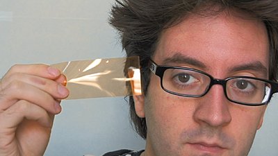

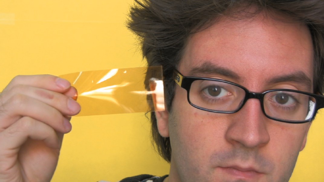

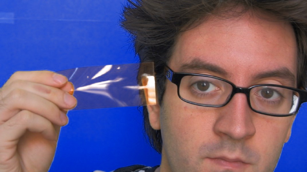

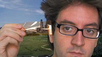

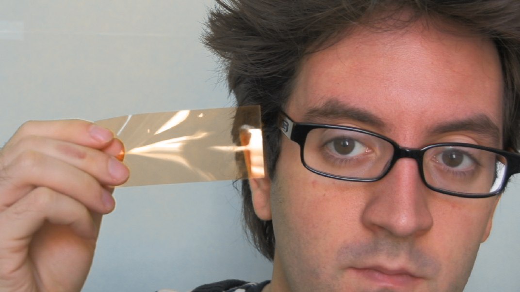

Dark colors will technically reflect less green, only because they reflect less of everything. The percentage of green reflected by a dark gray surface is the same percentage reflected by a light gray surface. But the surface quality of the subject will affect the percentage of light reflected -- in other words, shiny surfaces will show more spill than matte surfaces. So subject brightness won't affect the amount of spill suppression you will need to apply, but surface/finish will.
That said, I have to reiterate that people make too big a deal about spill. Modern software is extremely good at removing spill. Reflections are far more problematic than spill. So if your subject is sweaty, shiny, etc, you may have some issues. But a little green spill is a non-issue.
I've attached an example. It's a quick and dirty test shot I did in my apartment. The background is green posterboard from CVS lit with daylight. I'm literally right up against the screen, and the screen is very bright.
The first image is the raw capture (note: all of these were resized from a random 804 x 603 image I had on-hand, so they don't represent the HV20's image quality, which is much, much better)
The second image is a neutral-ish spill removal. Notice how completely the green has been corrected out. This is not a composite -- just a spill correction.
The third image shows that I can correct to any arbitrary color -- here, orange. This would help if you were compositing against a bright orange graphic like Bert was with his luma key example.
The fourth image shows that we can get all the way to blue.
The fifth image shows that we don't have to limit ourselves to correcting to a single color -- here, I'm correcting the green to the color of the background, on a per-pixel level. Again, this is not a full composite, just a spill removal. If we were to use a nice matte to composite this against the background, we'd be getting somewhere.
