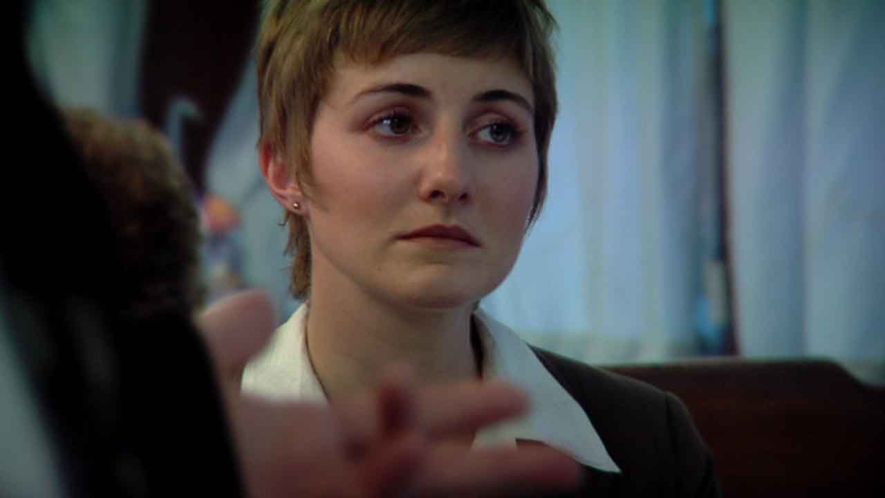

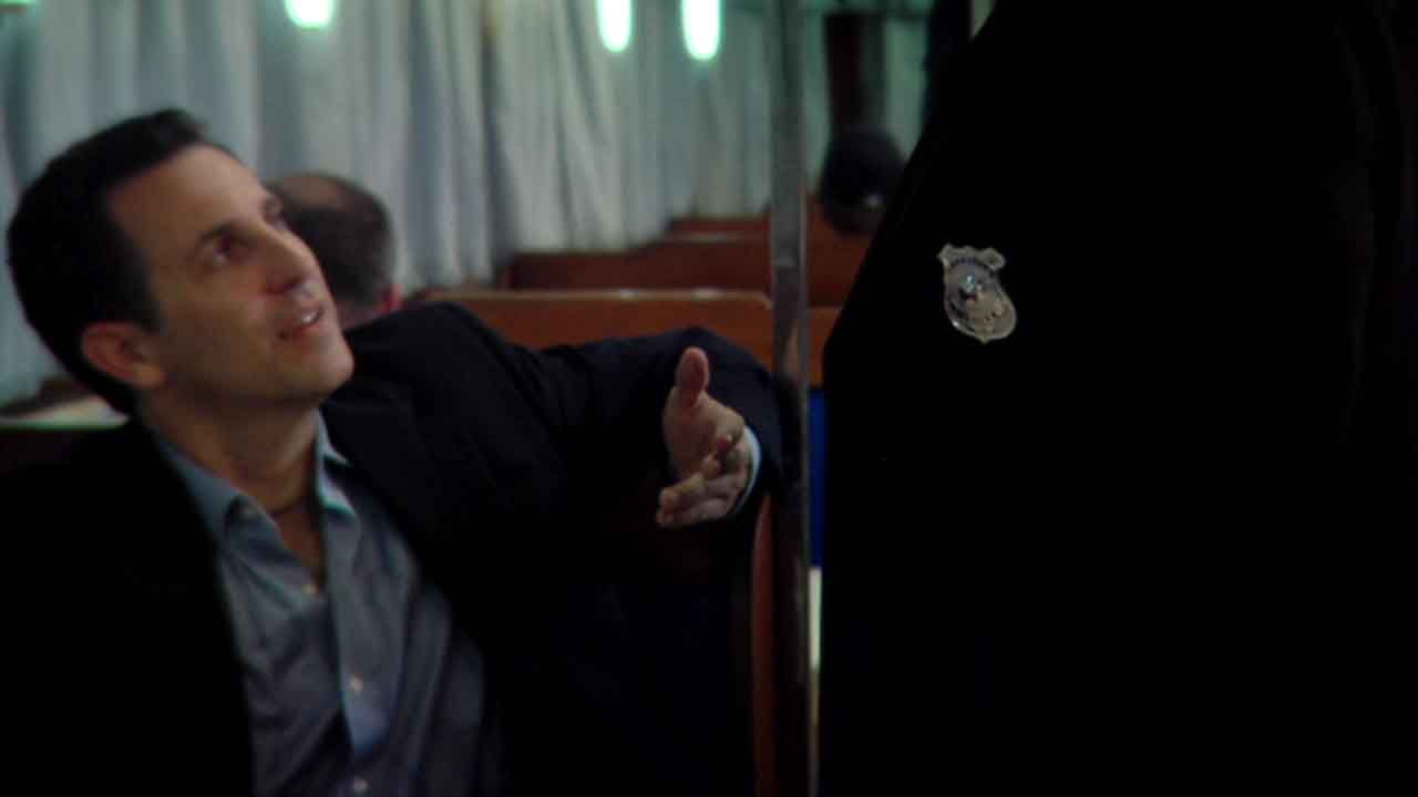

Here's what happened:
I got permission to film in an actual diner. We started in the afternoon, and did our last scene just as the sun was setting.
The action takes place in a booth right up against the windows. We had the curtains drawn, but obviously there's light from outside.
Except for the last scene we shot, were it is noticeably darker outside. This can't be explained in the story, it's an obvious continuity problem. I was thinking there might be a way in compositing to help this?

That seems to have worked!
Fixing lighting in background-darkerscene.jpg   Fixing lighting in background-lighterscene.jpg

Maybe those grabs aren't representative, but it doesn't look that off. What software are you using. Have you thought of selecting out the curtain area, and just adjusting levels so they will be closer ? In her shot, I notice it is a bit translucent, and I assume that is more what issue is ? Are the shots lock down or is there camera movement during shots. Is it possible to reshoot current and do background replacement.

Yeah, that's pretty representative. Basically it's only the 'darkerscene.jpg.' bit, which isn't very long, that's the problem.
Maybe I could even leave it as is, and suffer the slings and arrows of people who dig into stuff like that. But it would be nice to fix it, or make it less noticeable.
You are correct, it is the translucent light coming through the curtains.
I have Adobe Production Studio CS, so I have Premiere Pro CS, Adobe AE CS, Photoshop, Illustrator, etc.

From the look of it you should be able to pull a luma mask off of the curtains; it will take some cleaning up, but if you feather it you can use it to just brighten these up.
You can also double up the footage in AE and play with the blending modes and layer opacity to brighten up the scene.
If the highlights are headlights (from cars) you could duplicate the footage and timeshift it a bit, then track the lights for a moving mask. Only if the curtains are not moving and you are locked down.
