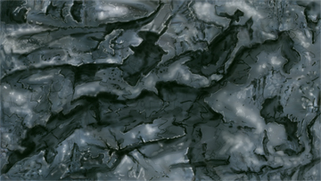

It's unfortunately not a simple as taking any old 2d image and wrapping it to a sphere with CCsphere in AE. That is of course what I am trying to do but you have to consider that the image at the left and right of the original 2D image must be symetrical or there WILL be a seam. Same goes for the poles, if the image is not stretched correctly than the 2D image will be badly distorted at the poles.
The Videocopilot tutorials are exactly what I could reference to both suggest the workflow for creating the sphere as well as an example of the 2D image before the CCsphere wrap is applied. If you look at his images of the earth surface and cloud texture, the leftmost side is exactly the same as the rightmost side, thus allowing for no seam to be created when wrapped to a 3D sphere. Same goes for the poles where proper stretching of the image exists so that when it is wrapped to a sphere the poles look good.
Try it with a basic drawing and you will see what I mean, unless things match left/right, pole stretch there WILL be seams and poor looking polar graphics once wrapped to a shere. You mention Tom that you have made planets from flat pics of the earth....well were they created with the above in mind? If so then of course they will wrap to a sphere properly.....but try it with something created from scratch and you'll start to see the problem.
For instance, try mapping this to a sphere in AE with ccSphere...it is an example of a original drawin I would map to a sphere, but creates the seams/poles problem.

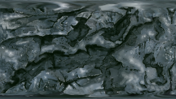

Hi Jim and everyone else who stopped by on this thread and offered advice and thoughts....I'm happy to say that Photoshop Extended CS4 can do what I needed, here is the quick test results....
This has some minor adjustments done to the image compared to the first example shown higher up in this thread. Notice in particular the top and bottom edges (the polar areas if it were a 3D image). I did a bare minimum of work to clone out and test the workflow in PS so it's nothing fancy but it's seamless and not nearly as distorted as it was originally when mapped to ccSphere.
So....the workflow I was trying to achieve works fine in PSE. Specifically there are a number of controls for mapping textures to 3D objects within PSE CS4 (you can have up to 9 texture maps per 3D mesh I believe and can edit the textures either while mapped to the 3D mesh or 'unwrapped' as a flat 2D plane. Simply clicking on the diffuse texture layer of the 3D sphere allows you to see the 2D image and easily select it and save it as a new file.
