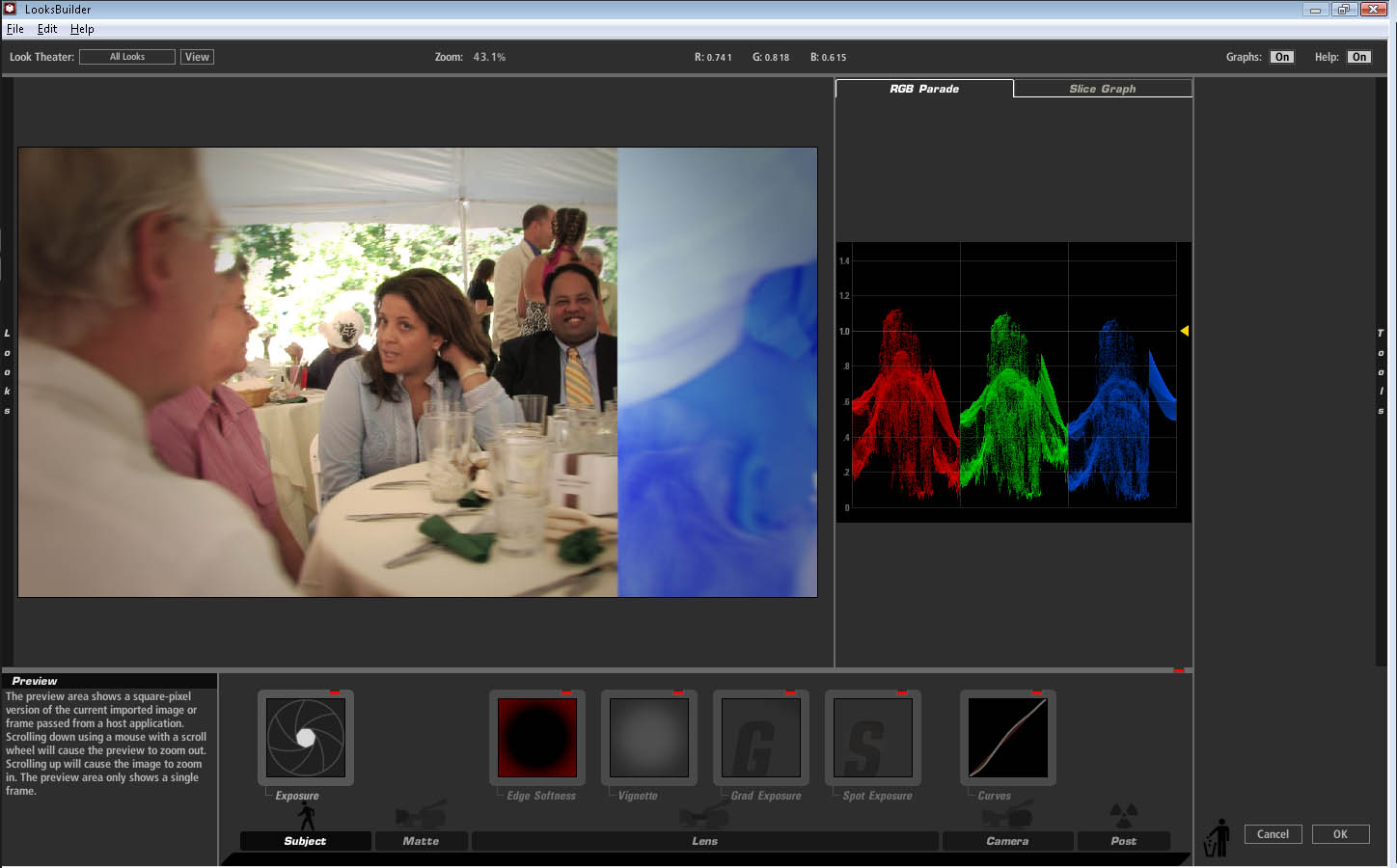

Installed a purchased copy of MB Looks this last week and I really love what it does but I have a problem. I'm working in a PP CS3 project that's native HDV 1080/24p (Canon 24f preset). I captured the footage in PP, and used HDV Split for scene detection so I'm working with .m2t files. I also have some files processed and rendered through AE that are QT with the Animation codec.

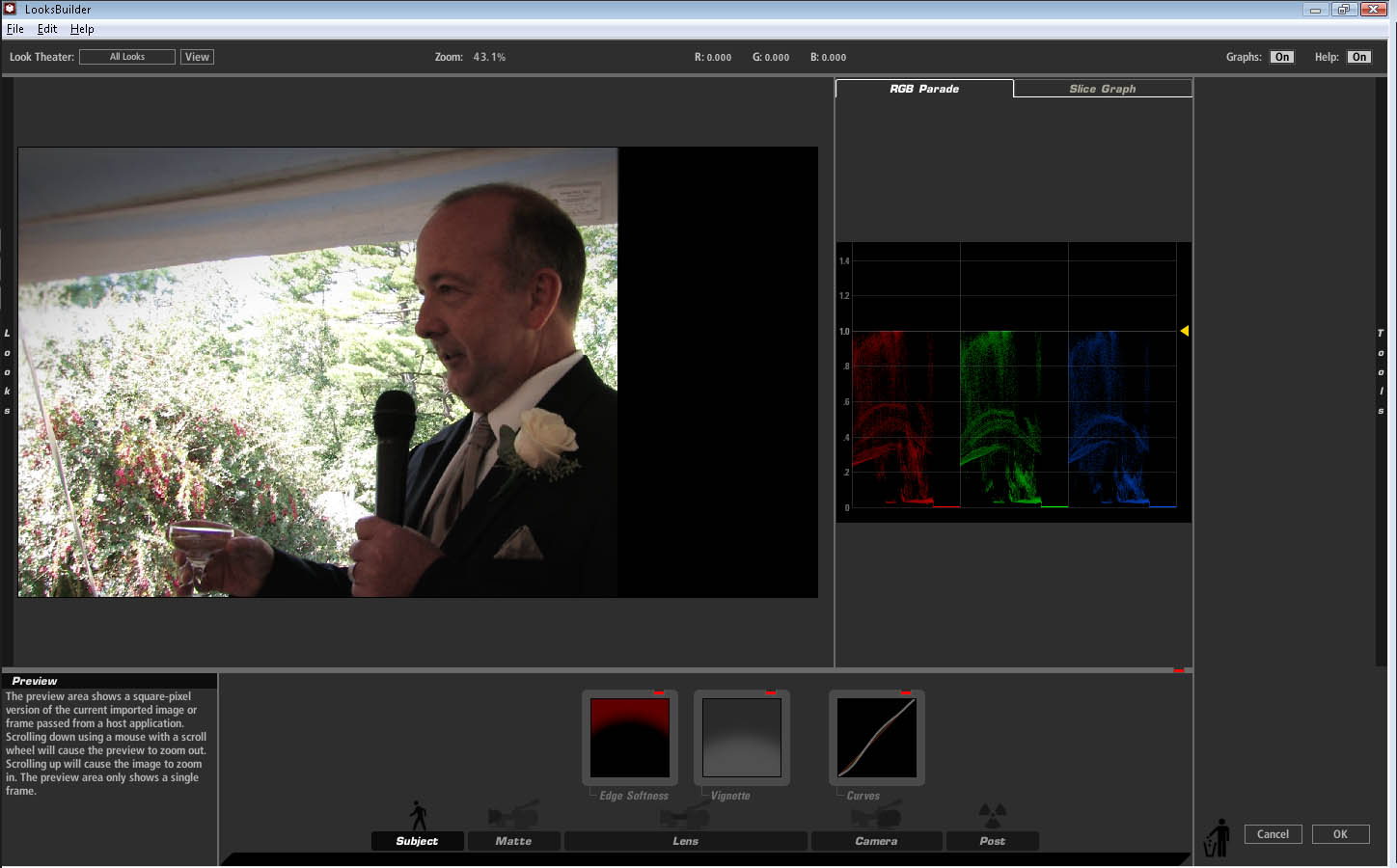

Everything's good except in the LooksBuilder, the .m2t files only display about 2/3 of the left side in the 16x9 AR frame display window. The image is undistorted except for the right 1/3 being black. (See first image below.) However, with QT files the display works fine.

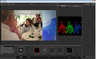

Also, sometimes the black section of the viewer is sometimes filled with distorted images from another clip. This is only with the .m2t clips. (See second picture below).

MB Looks: Problem with Looks Builder display-mbl-problem-screen-2.jpg   MB Looks: Problem with Looks Builder display-mbl-problem-screen.jpg

Mike... Interesting. I was only getting the problem on .m2t files but it was always. Even before I'd apply any effects.
That was until this morning. With the project done, I assembled the final timeline from a combination of nested timelines and a pre-rendered segment in QT with the Animation codec. Then I stripped out all of the unused footage to lighten the load on Premier. Displaying that master timeline resulted in video that was posterized, inverted and/or otherwise distorted. The PP "bad news box" was filling up with messages that MBLooks wasn't rendering certain effects on the clip (seemed quite random).
It was informing me that the display adapter was repeatedly being reset to what I think is a default mode. This is not uncommon with HDV projects I did prior to installing MBL. The adapter seems to lose its mind after I've been working with it for a while. "A while" can range from several hours down to one quarter of an hour if the timeline has a lot of effects on its clips.
I was going to call MBL support today but the machine's in a render that it said would take until the wee hours of tomorrow morning. I'll call them tomorrow and report any salient wisdom the can convey to me.

If I had to guess, I'd say its a problem with my video card. Probably memory issues there. I'll need to upgrade the memory, if possible, or make the jump to one with a little more stick.

Just to follow up on this, I upgraded the video card from the Nvidia 8500GT to the 8800GT with 512MB of memory and it's all jake now.
