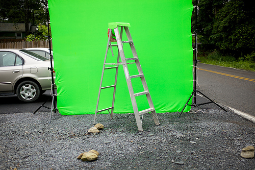

The best greenscreens in the world are from Composite Components in LA. They're not cheap, but they more than make up for themselves in the post time you'll save. The screens are almost supernaturally green, and nearly light themselves. See attached.
If you want to really goose up the greenscreen, gel your greenscreen lights with Lee 738 as I describe in this thread. Or use the green fluorescent tubes from Composite Components or KinoFlo.
And of course, good software can't hurt.
