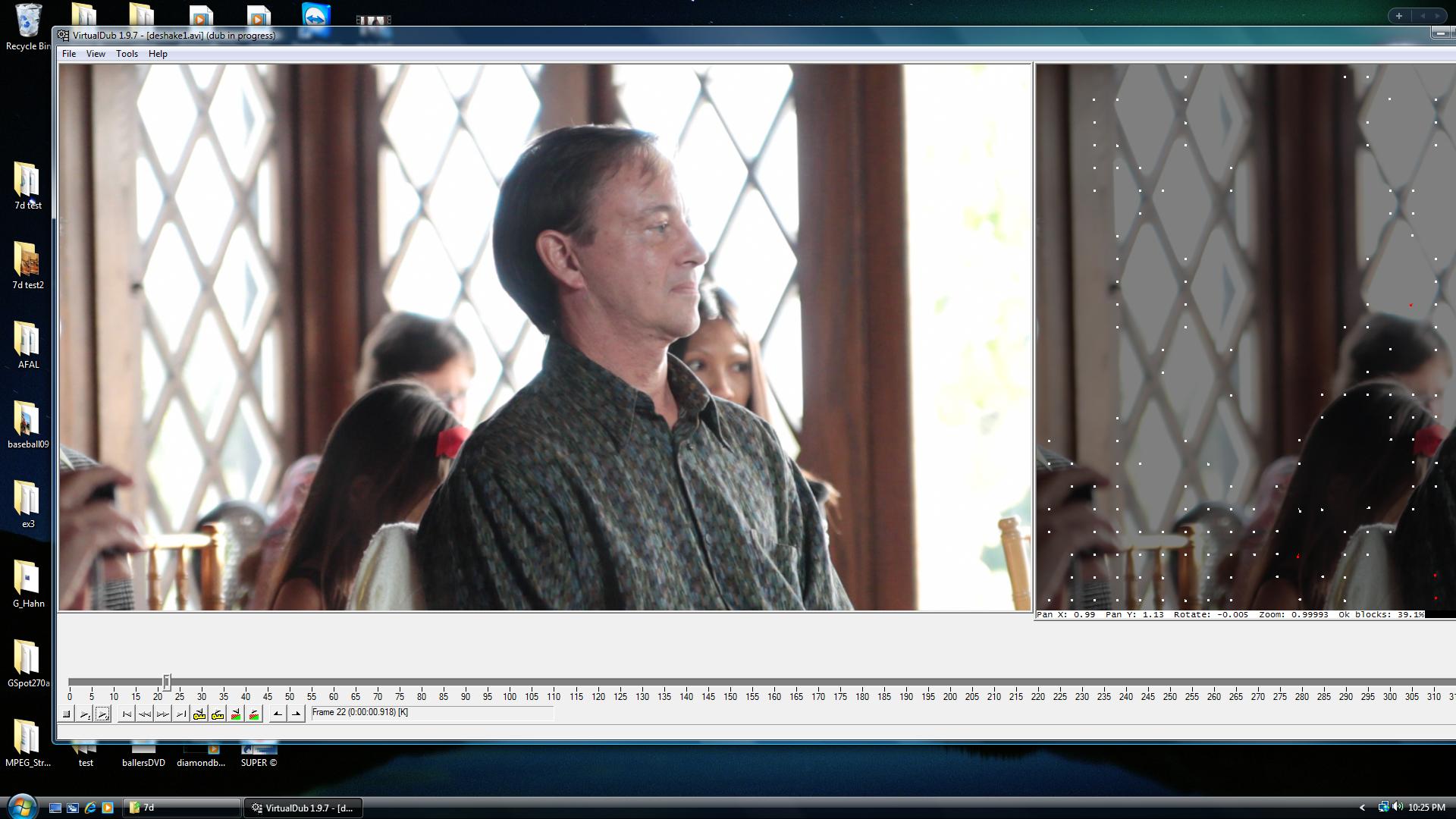

I installed the Deshaker plugin then I imported an AVI, set my parameters, made two passes and saved as an AVI. But my finished video still has the white motion tracking dots all over it and the numbers reading out in the lower left of the screen.
What'd I do wrong?

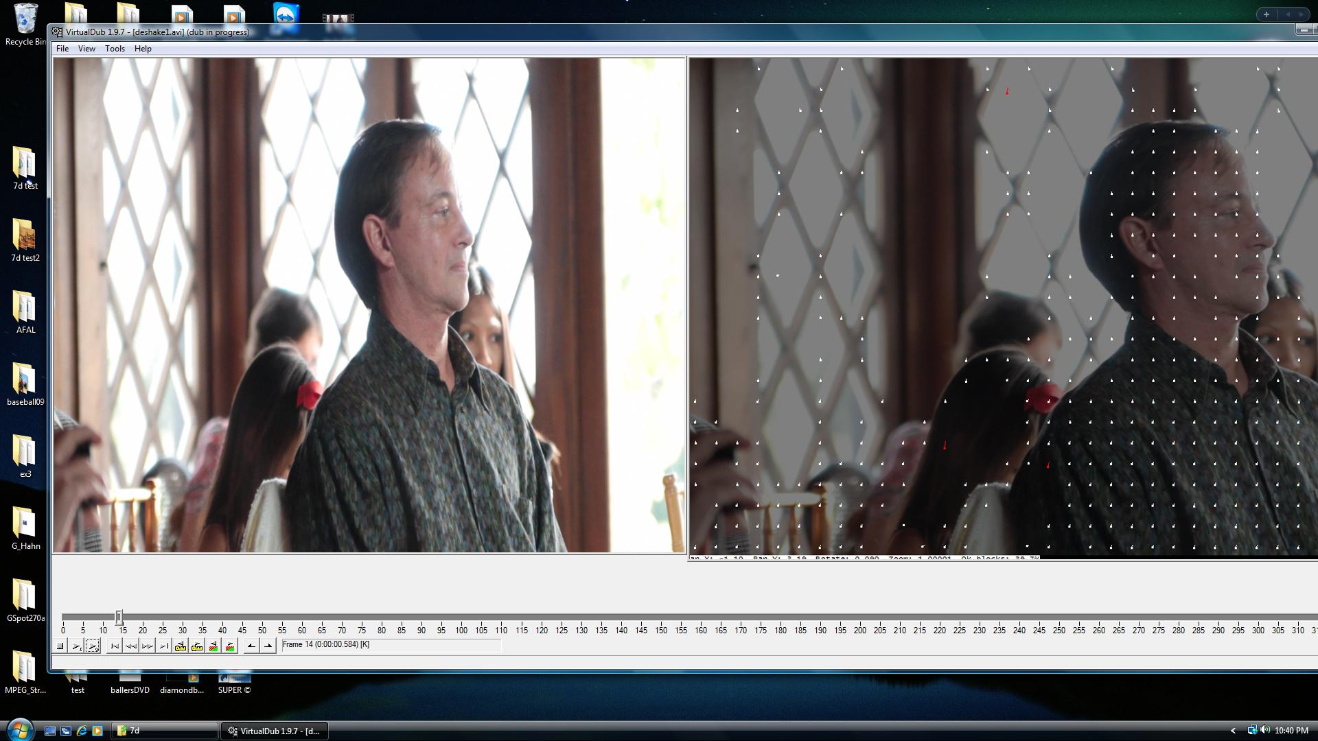

I click PASS 1 and then click the >0, the motion tracking dots appear and the clip plays to the end. Back to filters, Deshaker, click PASS 2, rewind then another >0 and again it plays with the white tracking dots. Save As AVI, it renders out and the new file appears on the desktop. That file still has the white motion dots when I play it as well as the ticker in the bottom left with zoom, pan Y and rotate info. And NO motion smoothing has occurred.
If I look at Virtualdub, in the B window, the original file says "This frame was not processed in pass 1. And nothing will play. Black screen There's also a yellow box in the right corner of the B window saying "No previous frame to match on".

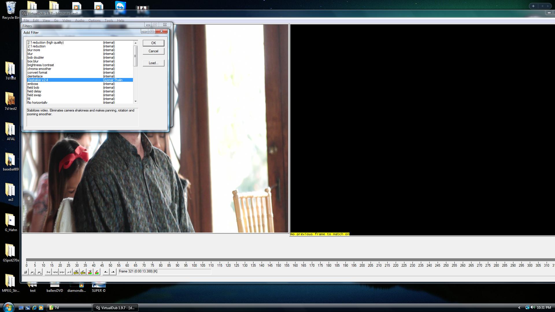

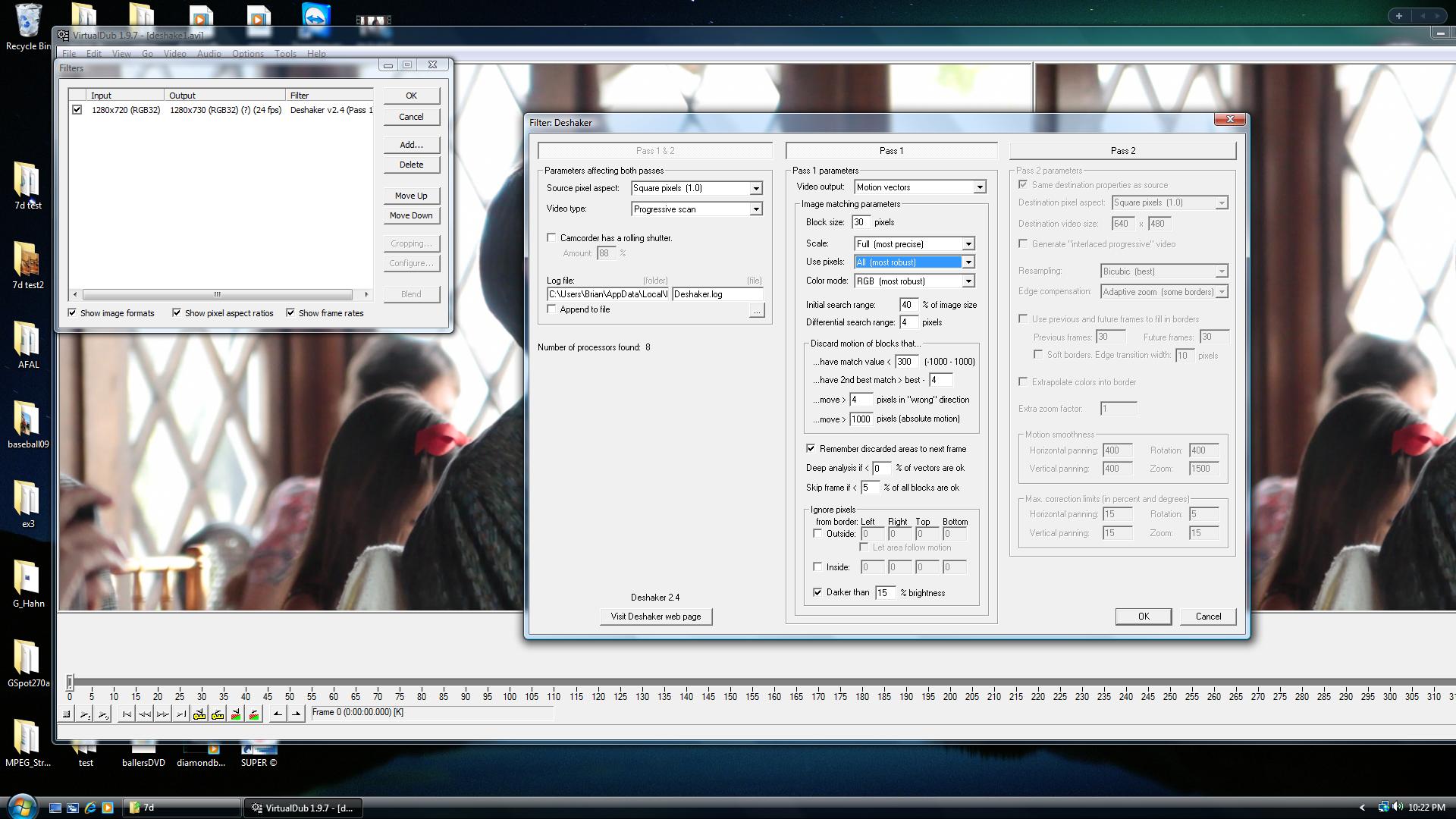

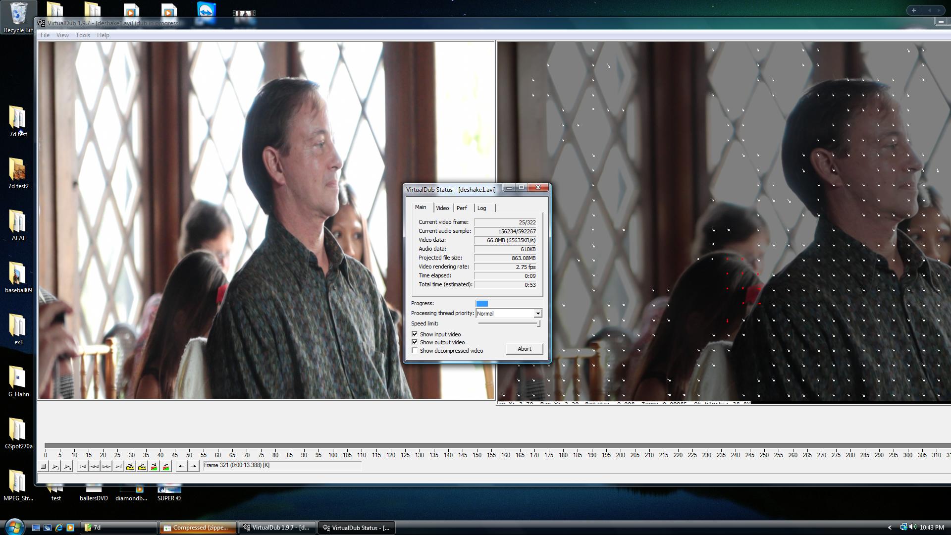

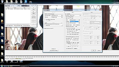

Put up a screen shot of the filter settings, and the little dialog when get when you click OK on the filter settings.

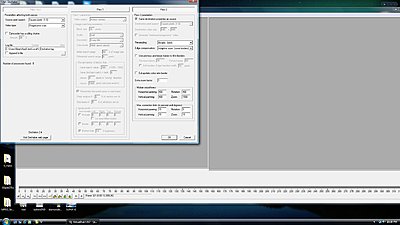

Old December 21st, 2009, 01:21 AM   #27
Posts: 2,290
Here's some grabs, hope the text isn't too small. Getting really good at the snow storm effect.
A short stabilization demo-dvinfo1.jpg   A short stabilization demo-dvinfo2.jpg
A short stabilization demo-dvinfo3.jpg   A short stabilization demo-dvinfo4.jpg
A short stabilization demo-dvinfo5.jpg   A short stabilization demo-dvinfo6.jpg

You have two copies of the filter running. Delete one of them and your problems will go away.

In a couple of the grabs, yes, I had two windows of Vdub open, but I've tried it every which way, and cannot get it to work. I deleted the zip folder DeShaker came in, didn't change anything either, snowstorm on the West Coast.
Question: it's the >0 button that applies the deshaker filter? And you literally make two runs on the file, pass one and pass two? Then save as. Why isn't this working!
Old December 21st, 2009, 12:01 PM   #30
Location: Tallahassee, FL
Posts: 4,100
Brian, listen to me....
Open VDub
Open your unstabilized video
Add a SINGLE COPY OF THE DESHAKER FILTER (you have two of them loaded)
Enter your setting for both pass 1 and pass two IN THE SINGLE COPY of the filter
Click the big pass 1 button at the top, and do the >0
Rewind the video
Open the filter and click on the pass 2 button. Click ok
Click the >0 again
Save the new AVI....
You are not seeing the results you want because you have two separate copies of the filter loaded and the top one is always doing Pass 1.
